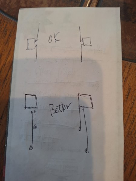

There are 2 styles of lift arms. Mine are the better style in the sketch. I've had both types. Both arms swinging back is best.
