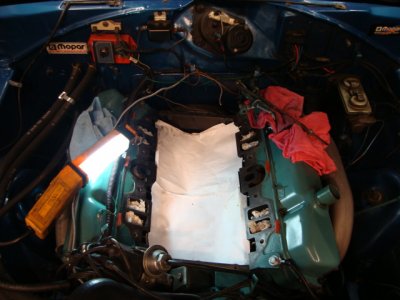

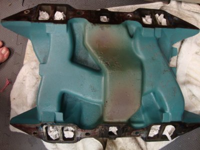

The other sites were right, just add a little RTV to the 4 corners of the bath tub gasket where it meets the front and rear hold down bars and you will be fine. Forget the other side gaskets, once the bath tub gasket is tightened it will seal.
i was in the same boat as you a while back....i thought that you had to use the gaskets too.
if the mating surfaces are flat and in good shape, you dont need the gaskets. clean up (really well!!) the intake and the heads, and put rtv along the length of the head and intake, paying particular attention to the corners, and you're good to go!! :hello2:
