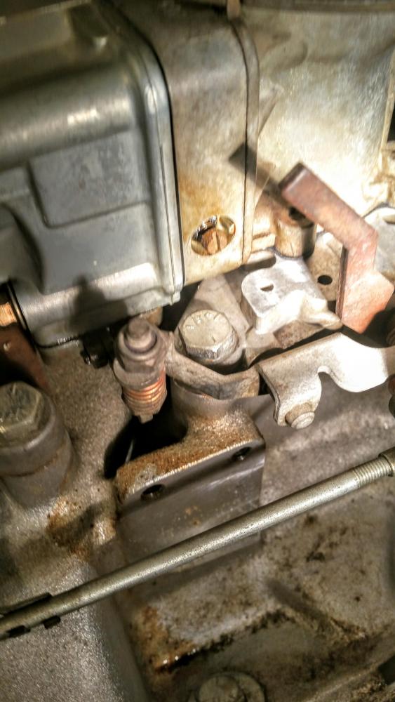

Man...it seems never ending with this car. I finally get a chance to install the vacuum pump and she won't start. Carb cleaner and cranked for several minutes with breaks not to burn out starter. She always took long to start but this time was abnormal. Turns out I have no spark coming out of coil (this will get replaced) I also noticed fuel is leaking from the center carb. Looks like it is leaking from the idle mixture screw.

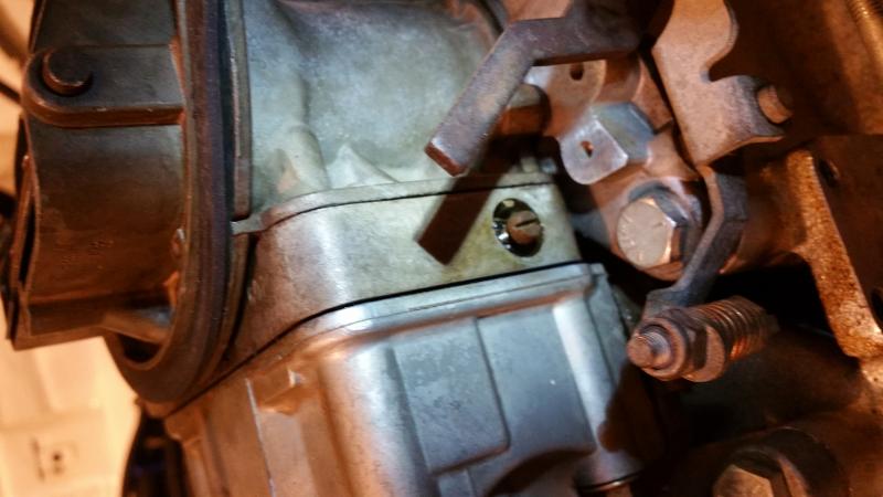

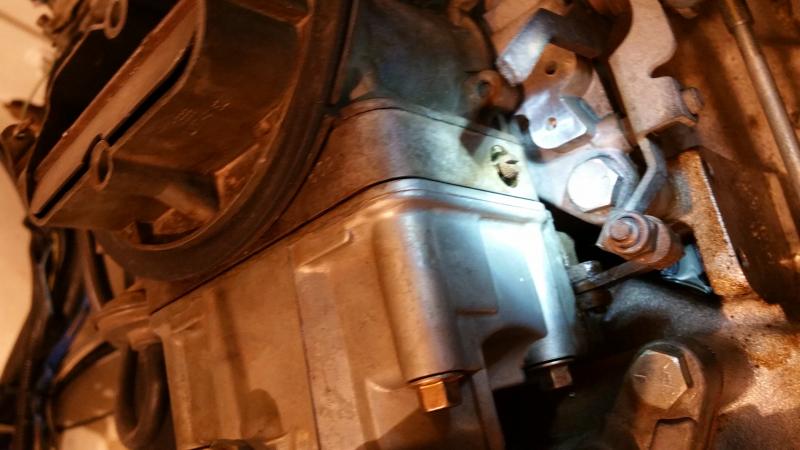

It looks like my idle mixture screw are too far out and this is where it is leaking from. I don't know anything about 6 packs. Need advice on what to do next with the carbs. Pictures dont show it well, but there is fuel pooled under where the idle mixture screw is

there's a small cork gasket/sleeve that seals the mixture screw and probably needs replaced. also take a good look at the accelerator pump and check the main body for warpage. busted ballast resistor may be your starting problem.

It is difficult to see from your pix but the idle adjust screws seal to the metering body with an o-ring type seal. These seals are usually part of the carb rebuild package. Remove the screw entirely, pull out the old seal, press in a new seal with your finger or a small socket wrench, just to get the seal to bottom out in the body and then screw in the mixture screw. In '69-71 applications (original OEM carbs) these screws adjust the fuel flowing into the metering body and ultimately into the throttle bore BELOW the throttle valves. The small milled slots, immediately above these idle feed holes are the idle transfer circuit, which help with the fuel flow during the transition from idle to main nozzle flow. Most 6 barrel cars (Plymouth) or six pack cars (Dodge) use this type of metering system. Also missing from your pix is the primary fuel bowl vent system.....usually a flapper valve on pre 1971 cars, except California using the CAP system of vapor recovery, then the '71 50 states cars used a vapor recovery system with a nipple on the fuel bowl and a hose leading to the passenger side valve cover air inlet fitting. The fuel vapors were stored in the crankcase and purged by the PCV on engine restart....everyone else used a charcoal canister. The original fuel bowl retaining screws were slotted....later Holley issued carbs used hex headed bolts.

I recently rebuilt my center carb. The idle mixture screws were at about 3 1/2 turns out. I replaced a bunch of gaskets, and the cork idle mixture screw gaskets, and replaced the too small #62 jets with 1 number bigger than stock #65s. Runs great and I am about 2 turns or less out now. My new accelerator pump diaphragm leaked, so I put the old one back in. I wouldn't recommend the Walker rebuild kit, that's what I got, and it had the leaky accelerator pump and didn't have a silicone fuel bowl check valve.
