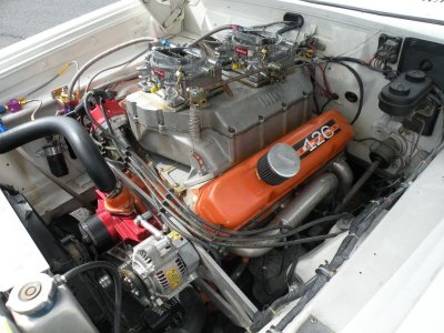

i have a 500 stroker with 13.2 compression with 440-1 indy heads with indy 440-25 crossram with .650 lift roller cam and just about got 700 hp.
you'll either need some more compression or more cubic inches imo.
