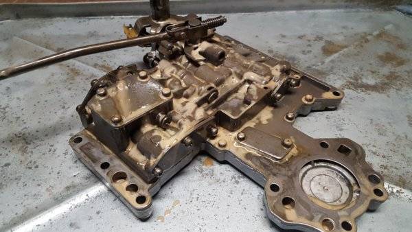

We're trying to get 20 year old oil/water out of the A904. The trans lines are off the radiator, drained the converter and we are pulling the valve body.
What else can be done to cleanse the trans before reassembly and refilling?
Should I be opening test ports, blowing air in holes, etc?
Thanks!

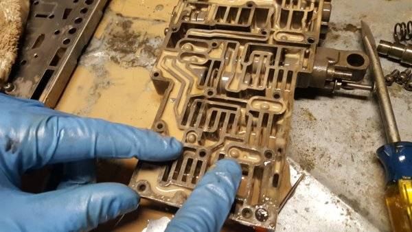

No rust in the trans but lots of what looked like light brown paint. I suspect the water sat in the bottom of the pan only and was then pumped throughout the trans for the first time when I pulled the car on the trailer.

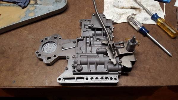

Been a while since I went through a A904 valve body. Is there a handy A904 assembly manual online? Just curious if I got the balls in the right spots.
Thanks.

After getting cleaned up, shift body looks good. Called dodging bullets!
