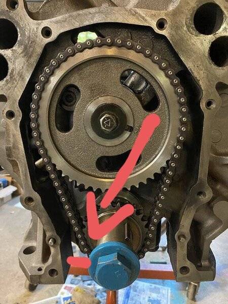

Ok so I borrowed a scope and I can see the piece . BUT I can't find anything to get it yet. The claw I have will not bend in the direction I need .
Here is a picture trying to show where it appears to be sitting .
I think it's basically sitting on the oil pan up near the very front of the engine .
