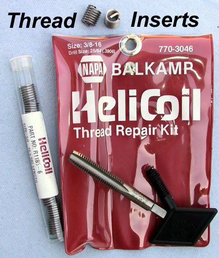

You can use a heli coil as a replacement...

that should be a screw in stud,no access to back side.do like pops said and use a heli coil setup.jb weld is not strong enough in that way,do it right.
Will save that idea in case all else fails.
