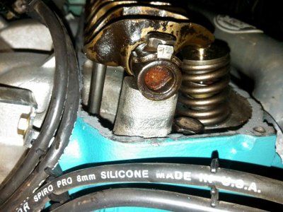

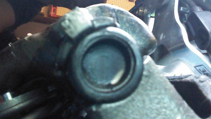

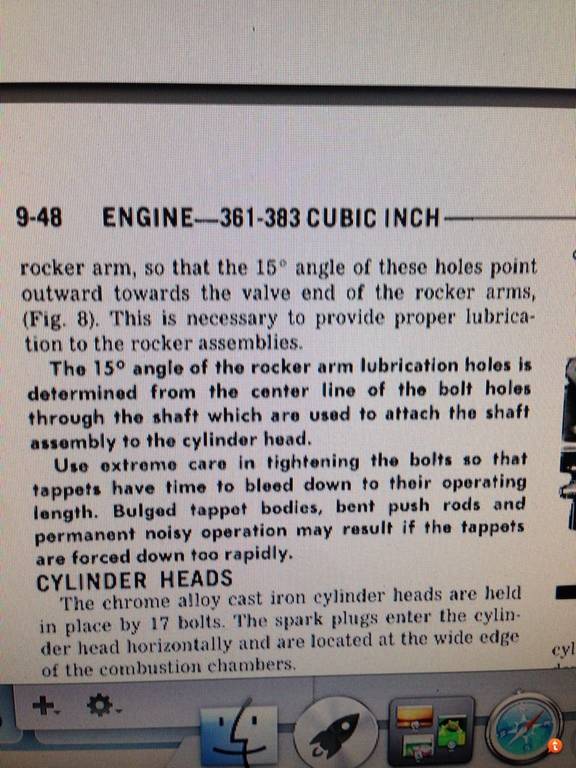

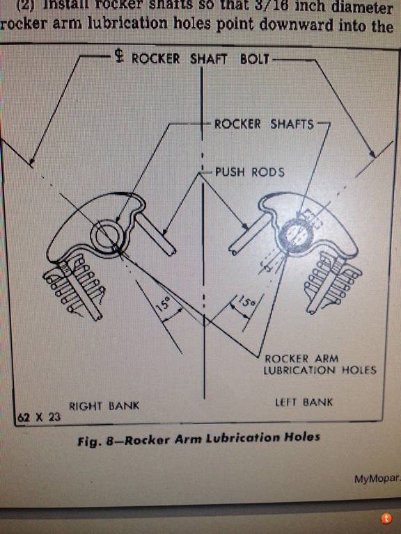

I am certain the oil holes on the rocker shaft are down, however I'm not 100% sure I had the "notch" of the rocker shaft facing the right direction. I looked all over google and in the 1967 service manual to see what this notch looks like to compare but no luck.
If you did have the rocker shaft in reversed, wouldn't you still get some oil ? Does anyone have a close up of what this "notch" looks like

a service manual would be your friend here...oil holes in rockers face down and toward the exhaust valve. Service manual shows this in great detail. Notch on shaft is at one end. When shafts are mounted correctly, notch will be at opposites ends of each other

Check and make certain the oil passage holes in the rocker shafts are properly oriented.
Ron
I think Snowtrooper hit the nail on the head (pun intended.)
Ron
that will not stop the oil from coming up to the head...if holes are not in correct location, it will just wear out the rocker arms & shafts
