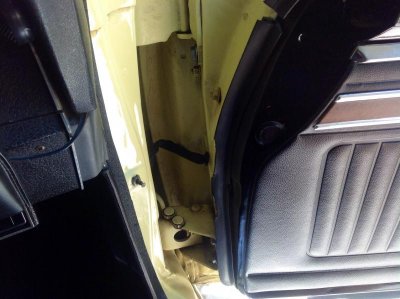

What are you working on? I'm doing power windows on a 70 Satellite. On mine there are dimples in the jamb and door where the holes for the wires go. Be sure the holes are big enough to pass the wires with the ends installed. Ma Mopar only used grommets in the holes and loom wrap over the wires in the open. The factory grommets are not easy to come by. I am using aftermarket ones. hope this helps.

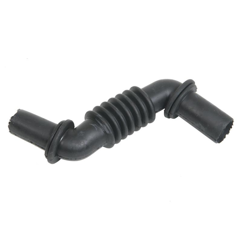

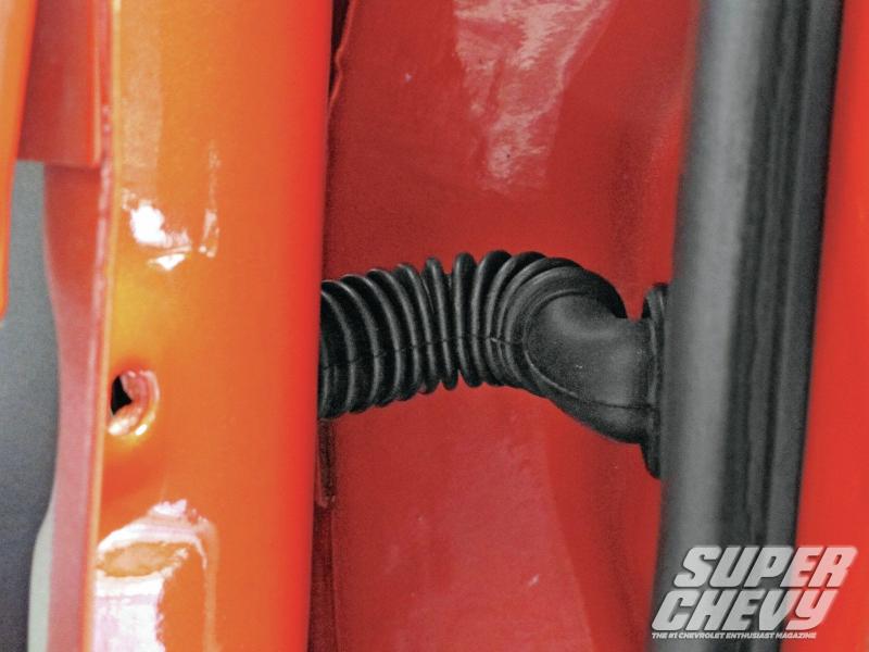

I was thinking of these from Electric Life sold by Summit. They have a 5/8 I.D.

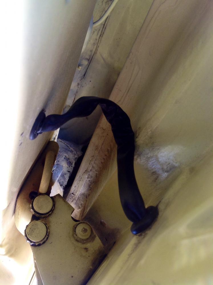

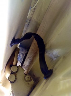

It is ugly in there! And a hokey set-up too.
Passenger side shown. That said, they have been reliable.

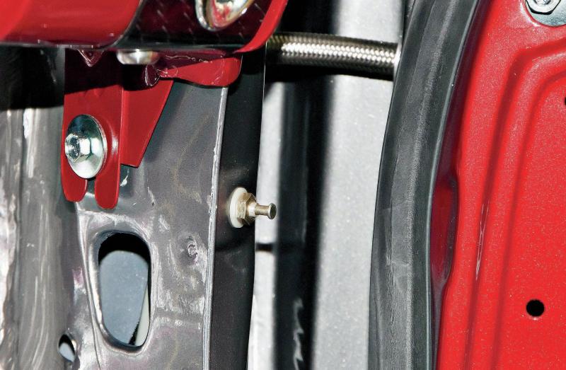

I found a photo of the loom above installed in a Chevy but the jamb looks the same since it's a 60s-70s car.

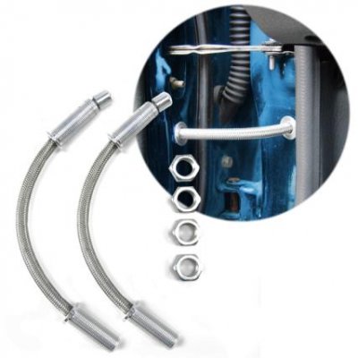

Dennis, this might work for you if you want something better.
Is that the summit item pictured?
Yes, it appears to be. I'll write a review once i get them installed and run the wires.
