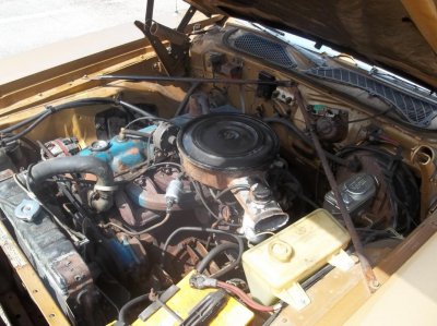

1st picture is my mostly original 120,000+ leaning tower or power

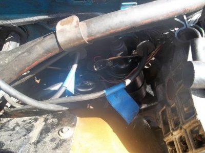

2nd picture is of the new coil and fuel pump

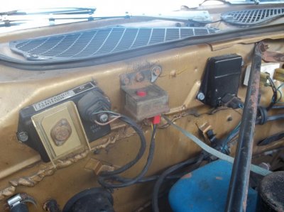

3rd picture is one where I am wondering what that square on the fire wall is with the red push button. It has a ground wire attached to it as well as a electrical connector in with the same harness that goes to the control module

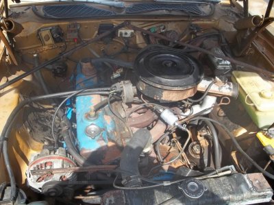

4th picture is just another one of the engine in my Satellite :) Dont mind the mess...its my daily driver or at least was till 2 weeks ago :p

Just now saw your pictures, if the belt is tight and it looks like you don't have a viscous fan rather than putting a wrench on the crank you can move the fan back and forth to see how loose the chain is. Easy but wear gloves or use rags, those blades are sharp.
