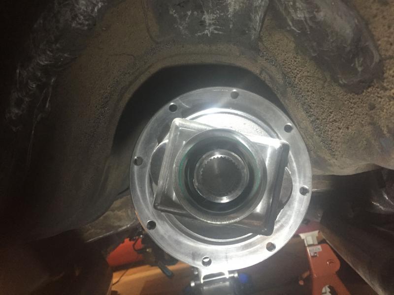

This photo shows the factory tailshaft housing, but unfortunately it's not a very good angle to see if the housing is centered.

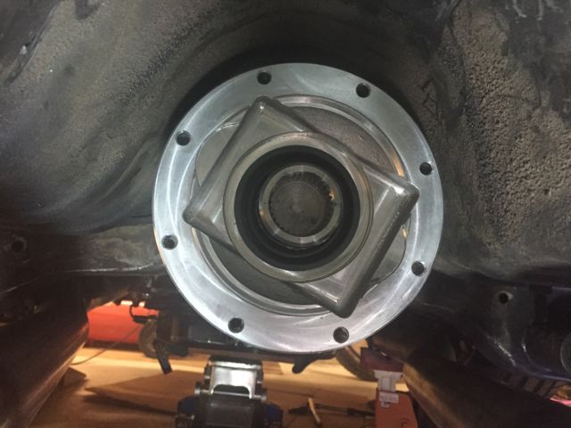

This is the new housing, from the correct angle. The lighting could be better but you can see (poorly) that the housing is to the right (of the tunnel / car) by about 3/4" from center.
I'm really confused. How can this be? The only mounts still in place (since the trans mount and crossmember are removed) are the engine mounts, and they only go on one way. How can the whole system be turned to leave the tailshaft housing off center? It's as if the whole engine is turned left (moving the tail right).
Are the engine and transmission off-center from the factory? Doesn't the driveshaft go down the exact middle of the car?

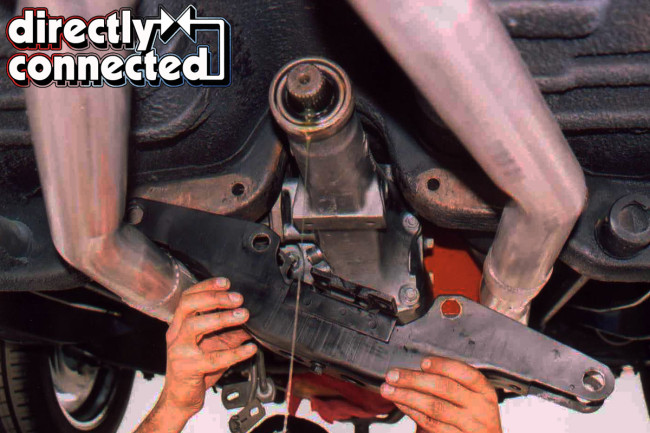

Here's a picture below from an online article showing the trans tailshaft (granted it's a manual trans but whatever) perfectly centered in the tunnel.
That's what I'm looking for. CENTERED!

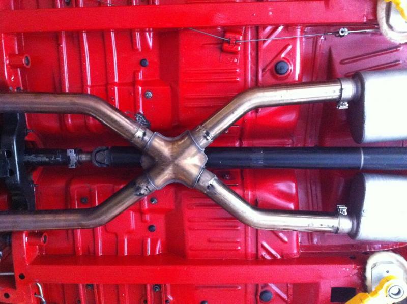

And here's another one, WITH a Gear Vendor, from this thread:
http://www.forbbodiesonly.com/mopar...87-1968-383-Charger-Gear-Vendors-installation
CENTERED in the tunnel.
And FINALLY, here's a good picture of mine. Sorry for not exactly level. At least the lighting is better!
That is just touching the tunnel on the right and 1.25" from the left. Something is wrong with my engine position! Either the whole engine and transmission are 3/4" too far to the right; or the engine mounts are out of whack and the engine is "turned" to the left (moving the tailshaft right); or the whole K-Frame is turned to the left (moving the tailshaft right). From the engine mounts to the end of the tailshaft has got to be five feet or more, so even if the engine or K-Frame is turned only a few degrees, it could account for the problem.

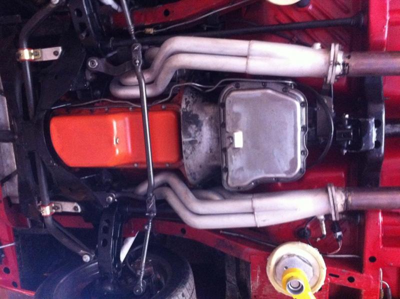

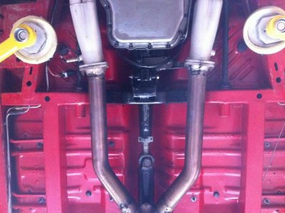

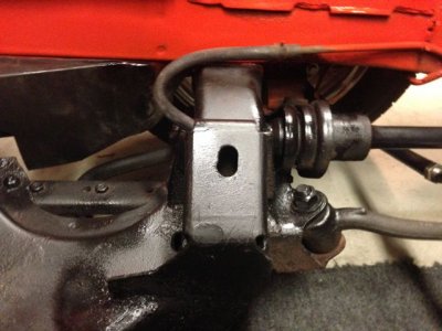

Glad I took a lot of pictures. Here are the mount pads - Passenger Side

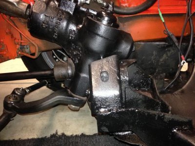

Driver's Side
The K frame shouldn't be able to move around much at all if any when it's bolts are loosened. If it does, you may have more problems than you care to address. Everything has a tolerance and even though the body panels have more, the chassis does not have much. If the K is off enough to mess up engine/transmission placement, it's also going to play big games with the front end alignment.

I loosened the motor mount to K-Frame bolts - one on each side of the engine. It turns out it takes about 2 minutes. They are REALLY easy to access. then I put my leg under the car and pushed till the tailshaft housing was banging on the far (left) side of the tunnel. Slammed it about ten times and voila. Done. When I tightened the bolts it came back a fraction, but not nearly to where it was. There is also a LOT of play in the rubber portion of the engine mount even when tight. I could bang the housing into EITHER side of the tunnel by pushing it with my leg. I see why guys switch to motor plates. That's a lot of torque loss.
Cranky, can you imagine what a .060 larger hole in the k/frame from the mnting bolt diameter would do 4' to 5' back in the drive line side tolerance travel. These allowances are there because they are needed for assembly. you can get a decent amount of adjustment by this method and I do it on all fit ups on these cars with a pry bar and someone at the gearbox and sometimes have to loosen the motor mnts. I know you are a very experienced mopar wrench but absolute dims. are not our friend in this type of assembly. I have never had the need to check the inside dia. of the k/frame holes and the OD of the bolt shoulders but next time I will check them with a dial caliper. Hi Grabinov, next time you are FITTING in a k/member put in the bolts and back them off a turn or so and make a couple witness marks with a scribe then move it back and forth diagonally to see what you have as possible adjustment. Good luck to all.
