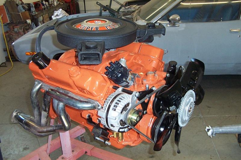

I'm trying to put this 440 together and hit a snag with the pullies. I'm pretty sure the crank pully is correct, but the water pump pully came seperate from the engine and I'm not sure it's the correct pully. It doesn't line up with any of the lower pully grooves and it's rubbing against the lower pulley. Any ideas?
Ah...pulley HELL.
Always been easier for me to get all from the same moter, and make sure I'm the one that removes them.
Sometimes I think they changed pulley specs every year plus different pulleys for both B and RB and both A/C and non A/C.
Is there a difference in height between the passenger-side discharge and driver's side discharge water pump housings?
That is a 4 groove a/c crank pulley and a non-a/c HD dual belt W/P pulley. I'd toss both. Are you running P/S?
does your alternator pulley line up with the pulley on the water pump? What year is that 440 from? My water pump outlet is on the drivers side and that crank pulley just looks wrong to me. Does the pulley still rub when bolted up to the pump?

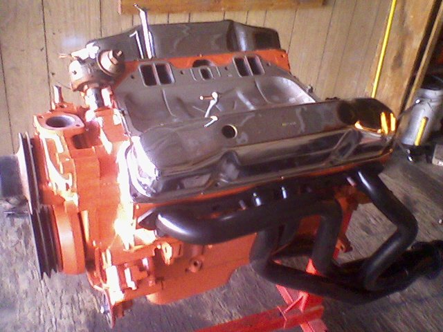

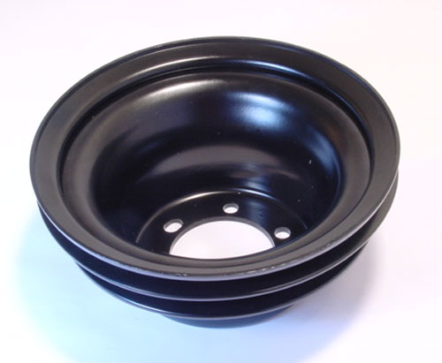

if you are not running A/C , i would ditch all of it. get you a pair of these. my P/S will run off the inside groove. they line up perfect , its just the angle. my water outlet is on the passenger side

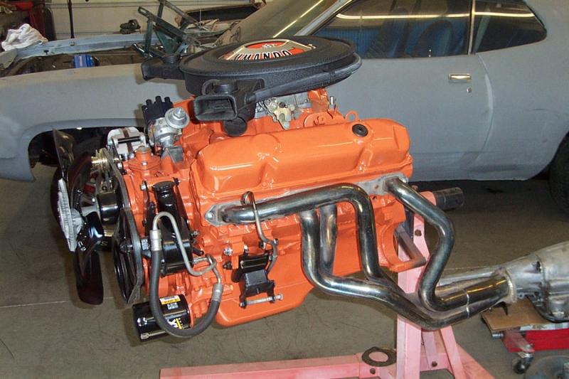

Interesting. My P/S is on the outside groove.
wow thats crazy, as you can see , there is no way i could run my PS on the outside groove and my WP pulley is almost against the WP bolts. maybe i have the wrong crank pulley , time for more research

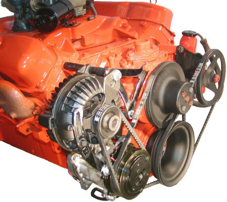

i found this pic . it looks like i may have the wrong crank pulley, SB maybe? but it works.
That's an interesting non-stock sanden compressor mount.
Isn't that a cool setup? Uses the stock pullies. Looks like the alt is moved out the depth of a pulley groove.
Looks like you need a deeper W/P pulley. It should pretty much hide the W/P bolts which are a special thin head bolt. Compair your pulley and top W/P bolt to mine.

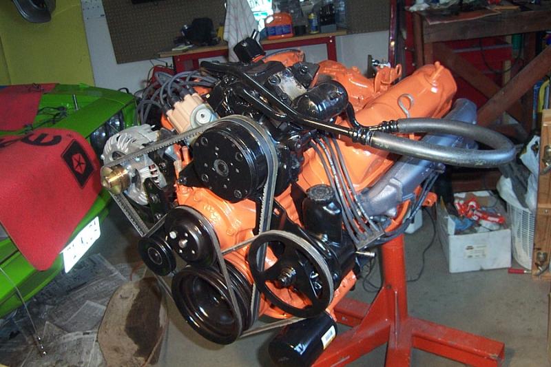

Nope the 4-groove crank pulley is for the A/C setup. Have a stack of them, how many did you need?:eek:
thanx,forgot about that dam idler pulley they add on for ac to run the wp.what a crap design,no wonder i dont run ac on any of my builds.
