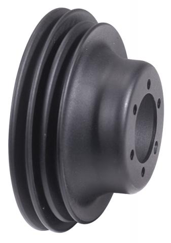

if you are not running A/C , i would ditch all of it. get you a pair of these. my P/S will run off the inside groove. they line up perfect , its just the angle. my water outlet is on the passenger side
So what are these? I need the diameter and the height.
Bru, you may be able to use the water pump pulley but that 4 groove is definitely wrong. I just ran into this exact same problem last week so I'm pretty well versed now. You'll need a two groove crank pulley which also has a smaller diameter. Don (moparparts) member on here has that pulley on hand, it is a used part so you don't have to pay as much.
super77se did you see my earlier post about your W/P pulley?
I can dig through my big box of pullies and see if I have a set. I think super77se has the wrong w/p pulley.
yes , i think you are right. i think my wp pulley is a small block cast iron water pump pulley , now that i look at it. it looks like the right one would line up with the rear groove .
