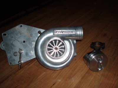

I need some help I am building a 400 for my 72 roadrunner and I am using kb240-40 hypereutectic pistons that I have already fitted to the stock rods but here is my problem I just picked up a procharger that I would really like to put on this set up . Can it be done and would it last?
paid 400.00 for the blower and it is in perfect condition

Yes you can,you will just have to limit the boost.What are the specs on the blower and the rest of the motor.
top ring gap will need to be increased. i'd probably use a cam with 112-114 lobe separation and limit boost to 6-8lbs. look on the KB website for additional info.
Yes you can make it work, but, It really depends on, What compression ratio ?, What are your current bore clearances ?, With supercharged engines, many/most times they need a little more clearances for the extra heat that a supercharger adds to the equation... What camshaft ?, Is it designed for boost ?, What are the piston down in the block ?, Are they at zero deck or what measurement down in the cylinder hole ?, What is the quench area ?, Have the heads &/or block been shaved/milled ?, What size are the combustion chambers ?, What size are the valves ?, What style of head gaskets & thicknesses ?, What ring sizes, materials, gaps & locations ?, What diameter blower drive pulleys are you going to use ?, What boost level ?... Forged pistons are far better for engines with high boost, you probably can get away with running the KB Hypertech. style pistons, you will probably need to limit the boost level for sure, to be on the safe side...

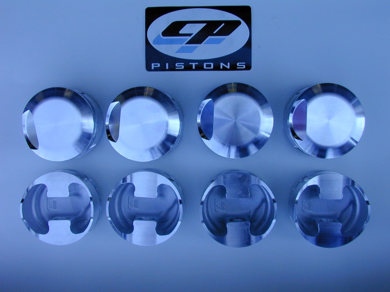

I would change the pistons while you have it apart.I went with Diamond this go round.Had CP last round.If you want to step on it with a power adder,new pistons:violent-smiley-100:

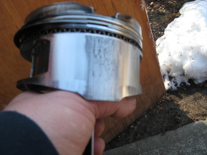

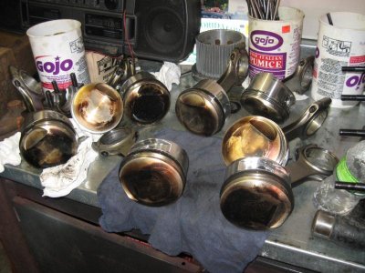

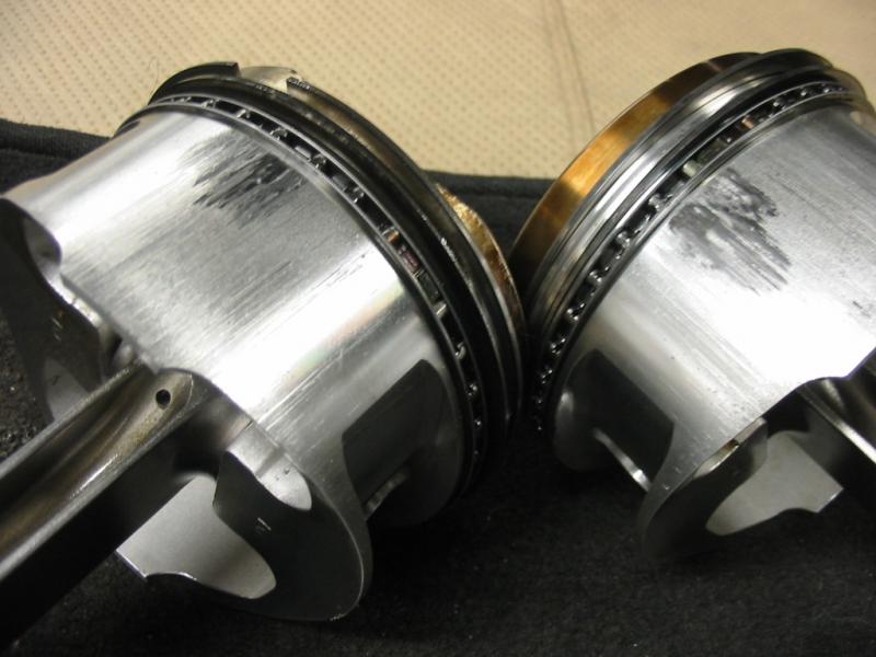

Here's some detonation damage.
