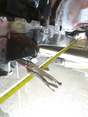

Need help I am not getting right measurement with red mark line like to know are you getting same?I am getting 1" less on K member.

Lol yes I understand what you mean.my question is on K member in the top where the engine sits there is hole and underneath of the K member so which hole shoud I take to do measurement of 54 1/2?

That diagram is looking at the bottom of the car. So, it would be the hole on the bottom side of the K member. Also, the 54-1/2 inch dimension is the distance between the hole edges, not the hole centerlines. I am looking for a sharper image.

Thanks a lot i was getting confuse here .I was taking measurement from top of the K member where engine sits thats why was not getting right number lol.
Pictures of text and diagram from my service manual are below. That 51.73 inch dimension looks like it is between the hole edge and and torsion bar centerline at the aft face of the K member. Stay tuned. Lol. I'll try to take some good images and provide them with the measurements.

Thanks alot for the help since 3 weeks I was badly stuck with measurements because the AMD frames I got the holes on it for measurements are not in correct place .trosin bar cross member center holes should be 37 1/2 And I am getting 37" so I have to fix that and both frame marking are out and plus 3/8 short.so that means I am big time screwed lol.

Is it possible if you get time can you give me the measurement from trosin bar cross member till K member center bolt cuz like to check if there is problem with bolt measurement please.
