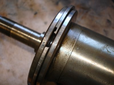

Broke down the power steering gear on my 72 Plymouth SSP today and found a broken piston ring on the worm and piston assembly. The broken piece was located in ring groove. I've done a quick search online but have not been able to find a replacement. I purchased a rebuild kit online but it did not come with new piston rings. Does anyone know if these are still available? I will check with my local parts store on Monday.

Call Dick at Firm Feel. Since the rebuild these I'm sure they can sell you parts.
I contacted Firm Feel and they will not sell individual parts.
I ordered a rebuild kit #350510 from RockAuto and the kit includes a Teflon seal to replace the piston ring.
