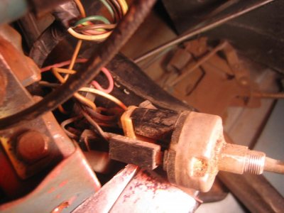

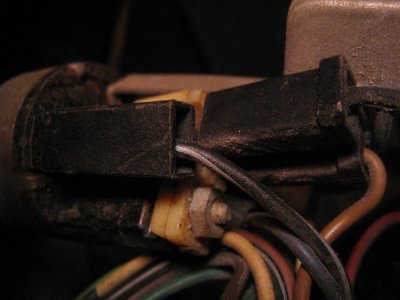

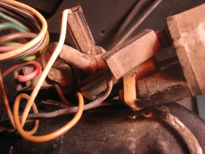

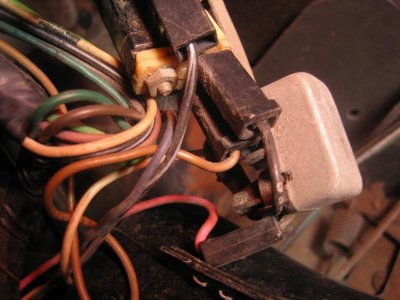

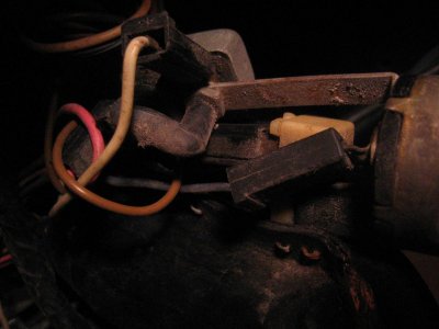

Put a new used dash harness in my 64 Belvedere. I have 4 wires left to connect. Pink, white, blue and black. There are 4 terminals on the wiper switch. Unfortunately, they aren't labeled as to which terminal is which. It is a different switch(doesn't have the electric washer pump option) than the 64 wiring schematic that I have as well. Does anyone have any guidance on this one? Maybe a picture of their own car?
Here's some pics of mine. It is a washer pump switch, but maybe it will be of some help. Sorry for the poor quality - these were taken with it still attached to the wiring harness behind the dash.

LOL - looks like a rat's nest, doesn't it.

Thanks for the pics and assistance. Got 'er hooked up and good to go!.
