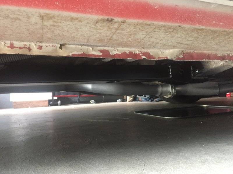

Not much in the way of Mods to keep you guys updated with but I did finally get around to having Hotchkiss Subframe Connectors welded on, also trimmed off 1/2” off the LCA Bumpers.. Michael I don’t how you were driving on the bumpers and a bad Idler Arm.
