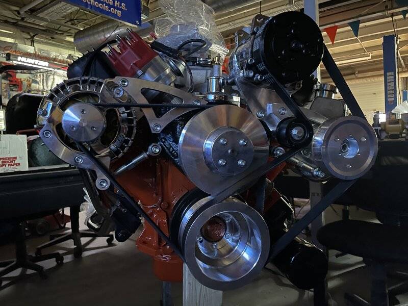

440 CI Big block. Edelbrock performance cylinder heads. Tuned to 460HP and 503 ft lb torque.I scanned through this thread but didn't see any specs on the engine.
Thank you. That isn't very specific though. Compression, cam, carburetor specs, etc.
Not sure what more info you are looking for.
Look, I have been supportive of this project so a question about compression and camshaft specs is not out of line. You respond with a laundry list with part numbers for engine bolts. If you built the engine, you'd know these things and be able to share them. If you had the engine built and don't know, that is another matter. There is no shame in paying a shop to build it.
There are many reasons why my question is an important one.
First, if the compression is above 10.0 to 1, a winner in California or Arizona may encounter detonation even with the best pump gas we have.
Secondly, The camshaft determines how the engine will perform and at what RPM it will make the peak power.
Ah, you used the Lunati Voodoo cam. By any chance was video taken of the dyno session
(or other times the engine was running)? Bet it sounds pretty mean!
