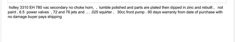

So I guess I missed something? Im not a carb expert. Please Enlighten me. Here’s the exact description for the item.

The ad you posted suggests 2 metering blocks and changeable jets for the secondary side, so it could well be a 780.

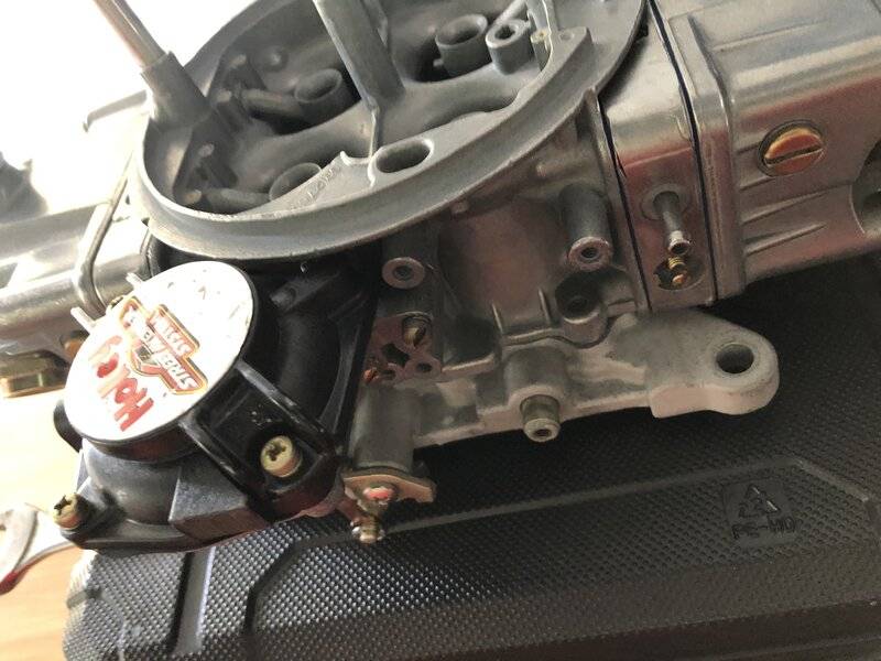

Here’s a few pictures. It’s a 3310-CH 780, as I understand was originally for 60’s 396 Chevy? Hope this is helpful in clarifying what I bought-

The carb looks to be very nicely finished. The vacuum canister has been changed to a later model unit. I wouldn't be afraid of it. The secondary metering block gives you more flexibility in fine tuning things.
