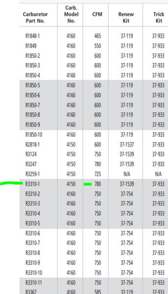

FWIW, 2012 catalog..................

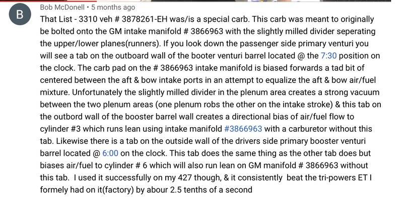

I understood some early 3310's were actually rated at 780 cfm. Later versions and those with a secondary metering plate were rated at 750 cfm. There was a way to visually confirm by looking at the inside of the carb, but I can't recall now what it was. Anyway, I do have a very old 3310 with secondary metering block and at the time confirmed it was one of the 780 versions.
The ad you posted suggests 2 metering blocks and changeable jets for the secondary side, so it could well be a 780.
The small pop and flames I'd attribute to a lean out condition because of the choke not being involved. In my experience a 50/50 chance the power valve was damaged. You should be able to still try and start the engine, but if the power valve is damaged it'll run richer than normal. I've run them with a blown valve for weeks until I could get to going through the carb. Idle would stink pretty good and sometimes the rich condition made it necessary to crank more than normal for restarting, but didn't do any real harm to anything.
The Holley model 4150 R3310-1 rated at 780 CFM is a great carb. Yes, it has a secondary metering block with replaceable jets AND A SECONDARY POWER VALVE provision, if former owner has not installed a power valve plug. It hss down leg secondary booster venturi. The "newer" carbs are rated at 750 CFM, model 4160 and has a secondary metering plate.
My experience is: IF a power valve has failed, due to a back fire, the result will be an extremely rich mixture, because manifold vacuum is pulling fuel directly out of the fuel bowl, thru the open power valve's vacuum passage, into the engine THRU the ruptured power valve's diaphragm. This extremely rich mixture usually results in stalling, black smoke exhaust and generally piss poor operation and is instantly recognisable.
Just my opinion of course.
BOB RENTON

As previously noted by others, and your article, the origional Holley 780 CFM was designed for GM's 427/425 HP application. The after market Holley 780 CFM, was an adaptation of that GM design, modified to include the bolt on Mopar throttle cable bracket and the Ford C-6 auto trans downshift lever and spring. This carb was designated by Holley as a model 4150 R-3310-1 and flowed (advertised) 780 CFM. It has down leg secondary booster venturi, secondary metering block with a removable secondary power valve. The carb had an adjustable hot air choke coil, PCV and both manifold vacuum and venturi vacuum spark advance ports. The choke system was convertible to either electric or manual operation with a Holley kit.
The present day Holley is a 4160 design model R-3310-2 or -3 or -4 using a secondary metering plate and straight secondary booster venturi, with a slightly smaller secondary venturi dimension. The user could always add the secondary metering plate with screw in jets in lieu of the fixed orifice plate as origionality supplied to approximate the orifice dimensions, to make tuning easier.
The origional 780 CFM R3310 and the -1 variant are available on eBay and the net. The subsequent variations are available as new and both old and new designs have vacuum operated secondaries. The double pump proponents have their preferences as well. IMO....The Holley R3310 is an EXCELLENT carb suitable for almost all applications. Plus, Holley carbs are easy to tune, with most parts readily available. Just thinking out loud....
BOB RENTON
