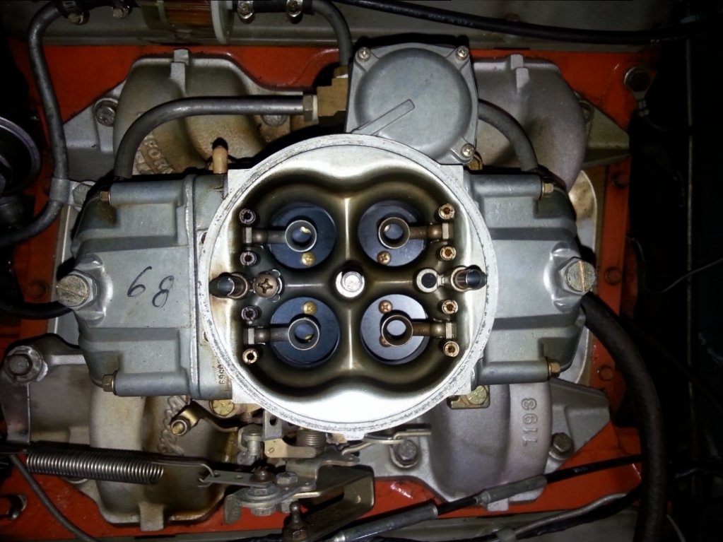

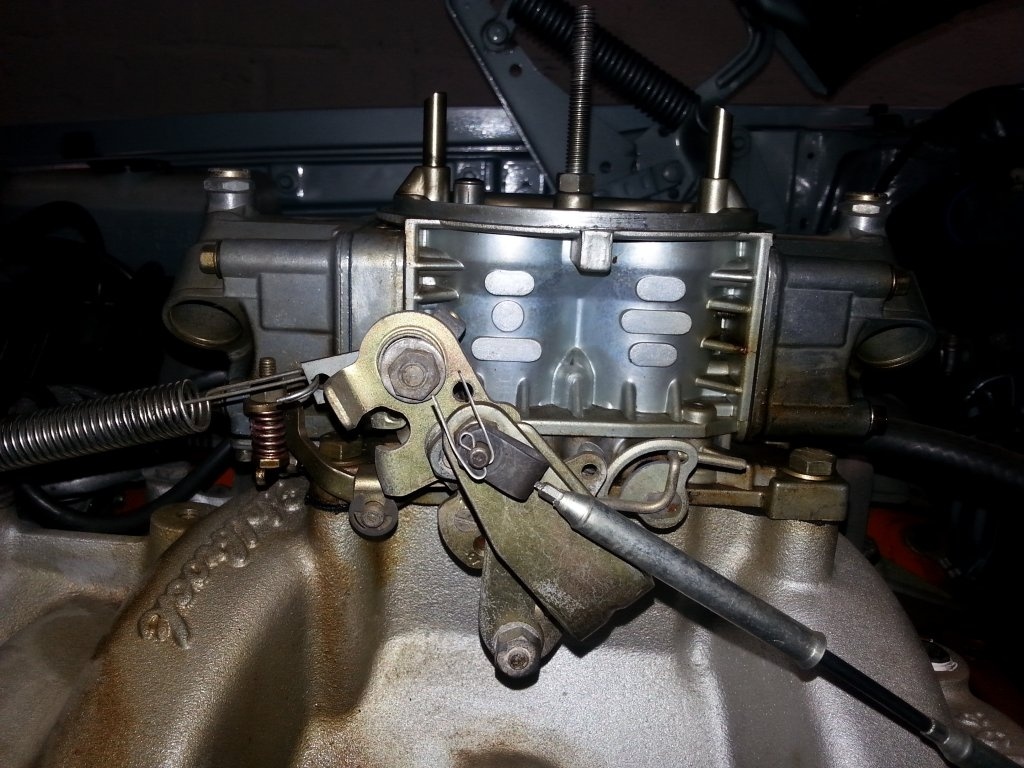

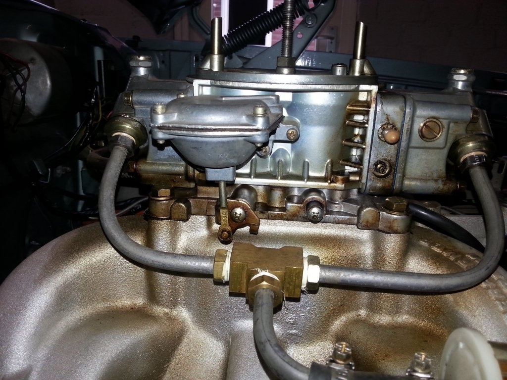

After sorting out the cam in my 440 I now need help identifying my holley carb.
It has an issue with the ported vacuum. There is a nipple on the passenger side front metering plate but there is no ported vacuum on that connection. For now I have the distributor advance connected to the manifold vacuum but I would like to get it to a ported vacuum port.
Therefore I want to take it apart. Where can I get the correct gasket kit for this carb, and what kind if holley is it?

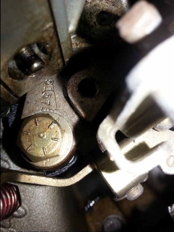

See pics. It's a single pumper four barrel without choke tower (not machined away but never been there) and vacuum secondaries. The only number I could find, 51573, says it's a 750 cfm.
Could it be that being a chokeless carb that explaines the lack of ported vacuum?

your carb looks like its a Heinz 57.
the center throttle body looks like a "Proform" piece to me.
pretty much any Holley style 4150 kit will work
That explains why there aren't any numbers on it. It might also explain the ported vacuum issue. Being a proform main body it probably doens't have an orifice drilled just above the throttle blade to supply the ported vacuum signal. With the holley metering plates still having the nipple it just connects to nothing.
