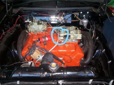

you can just see the spring here and it attaches to the center pivot this has since bben refined a bit but still remains in the same locatin
I appreciate everyone's help but I took the Holley 660s back and bought the new Edelbrock AVS2s instead. A & A Transmission sells the complete fuel line kit as well as linkage so I just went that route. I sold the original 64 cross ram and Carter carbs, fuel lines and linkage.....the guy wanted everything. My Belvedere is a Max Wedge clone so correct number parts aren't important to me but to someone who building a correct car it is.....I'm happy and he's happy. So thanks again for your help
