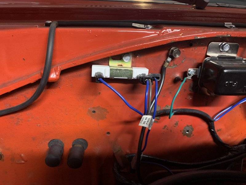

Curious how you did your ign ballast resistor and if it would work on my 66 charger with 383. I’ve been installing a sniper system
My ballast has a jumper wire internally. It’s there for the look of being factory.

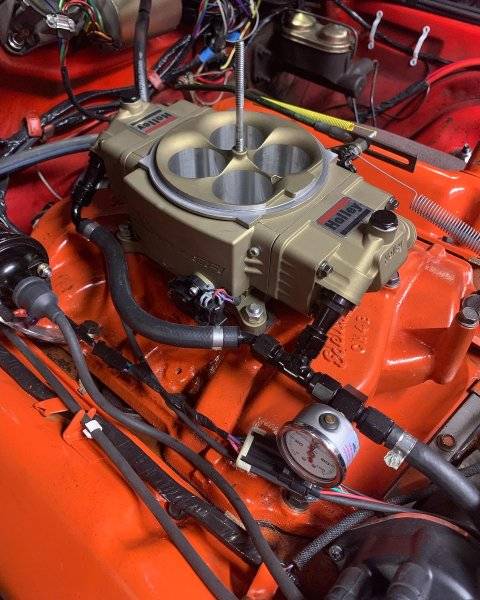

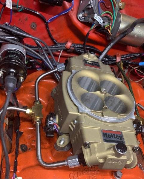

Here’s mine, I’m working on fabricating the 3/8” stainless hard lines still.

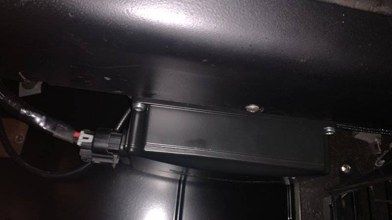

Where did you hide that Sniper ECU box? Is that below the dash on the passenger side?
I am still trying to figure out where to place it, IIRC it is about 6x4" and will be a pain to hide it in the engine bay.

Yes, I made a custom mount for the Hyperspark.
I’m using a A12 plug for the pink 12V for the ignition on and power while cranking.
The ballast has a jumper wire inside to keep it looking factory.

Good spot to hide it indeed, I will look into how to get all wiring done if I place it there.

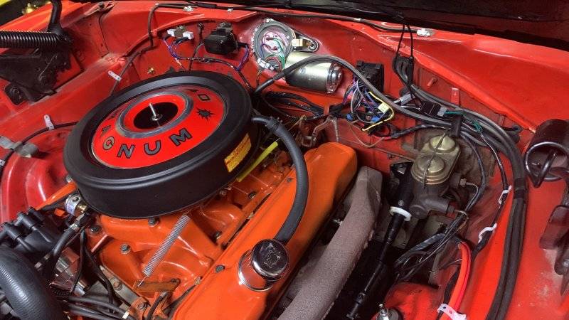

I used a complete Hyperspark kit. I Mounted the ignition box inside passenger side firewall. I had to extend some wires. Mounted the Coil on passenger side inner fender kind of under the wiper fluid bottle. I took the 2 wires off of the ballad resistor, tied them together and wired it in to the pink wires for my 12v source.
