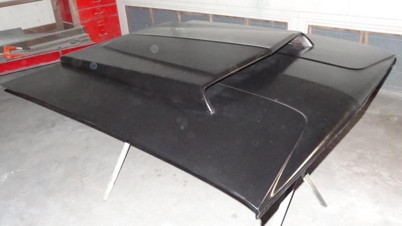

I just got a fiberglass hood for my Coronet and also got lighter springs for the hinges. I'm not sure how to change them without loosing a finger
The new springs are smaller diameter and I'm not sure I really need to change them either. The hood has a scoop added. Any ideas?

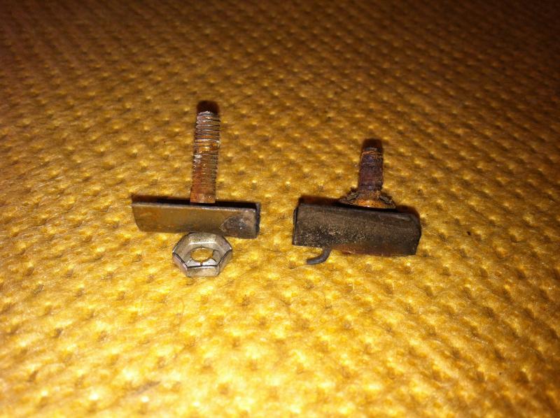

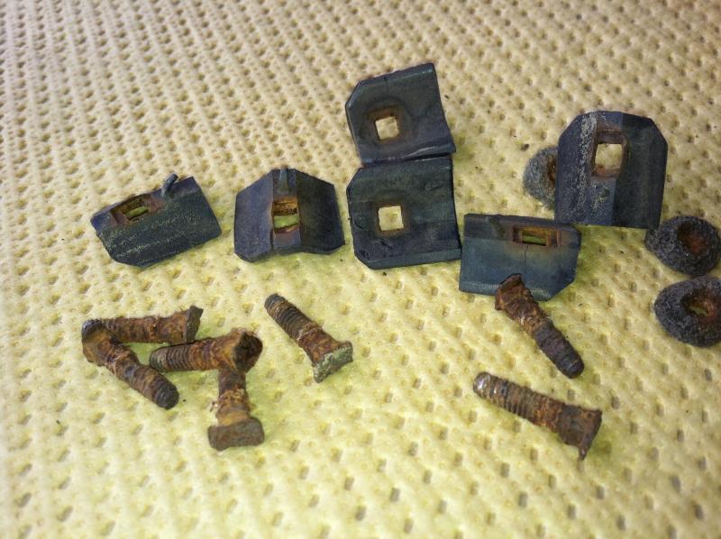

Well I drilled the front edge for the mldg but the original retainer studs aren't long enough. Does anybody know if anybody has them with longer studs?
Post a picture of the back of the molding showing the existing studs.
The retainer on the right is the original. The one on the left is from a piece of dash trim and it barely pokes through

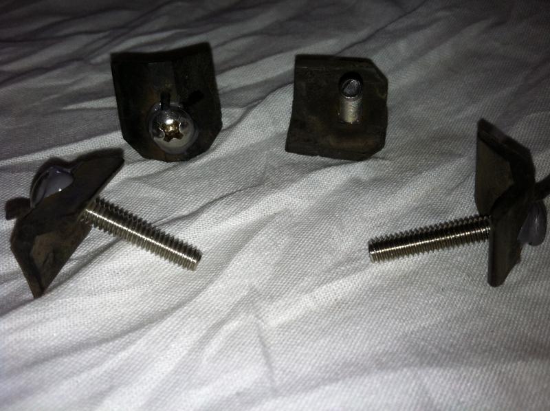

I was able to remove the old studs from the retainers Then I just went to the hardware store and bought some 8-32 stainless Phillips screws. jB welded them in place. Just going to use nyloc nuts.
