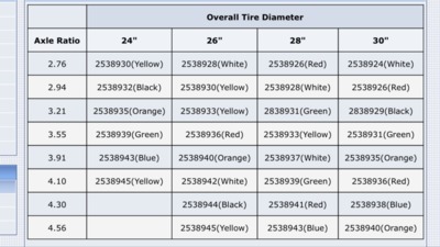

hey all. I just got a refurb speedo in the car, and the (known wrong) speedo gear of 26 teeth read faster than GPS speed. I ordered the”right” speedo gear of 33 teeth (28” tire diameter, 3.55 rear, on my 727) and it reads slower than GPS speed. I don’t know where to blame for the “right” gear reading wrong, other than probably a slightly off speedo cal. I’m not removing it for re-cal.
SO: who’s got a spare 30 and 31 tooth laying around that I can borrow? I really don’t want to but 2 more $60 gears to figure out which one works for me. I can either borrow yours the return, or buy the one from you that works for me... or I can trade you some of my 26,33, and 36 tooth gears that I have. (PO threw in the 36 saying it was the “right” gear, but it’s way not.)

I did the math as R/T Boy suggested and it appears to be a pretty consistent .86 ratio, so instead of the 33 I put in, or the 26 that came out, I need a 28 tooth pinion.

All the calculations and charts say i’m supposed to be using the 33 I put in... but with the 33t, at 60 indicated I’m running about 70 GPsS (roughly).

Something just doesn't seem right. On my Road Runner with 275/60/15 - 28" tall tires and 3.55 gears, I am running a 37 tooth speedo gear. 60mph actual speed reads 59 mph on my dash.
I've never heard of using the mathematical formula stated above, but I'm sure it will work. So if I take your 33 and multiply it by 1.14 (which is 100-86) it comes up at 37.62 teeth. And that is right about where my car is at.

That’s all the fun of magnetically driven speedometers, haha... yours is also a 727 with normal gear sets in it? I have the same tires and same final drive as you, and if I stick a 37t in mine it’ll read 50 when I’m actually going 65, lol.
I believe that in your case, your magnet is a bit overpowered, causing you to need a bigger gear than mopar would tell you, and mine (even though just refurbished) is a bit underpowered and requires a smaller gear to get the right needle sweep.
But I know that my speedo cable is old and doesn’t fully and properly attach the the back of the speedo, so I’m going to throw a new one in, in the hopes that maybe it’s just not “fully” engaged and maybe the new cable will speed up my gauge. If it doesn’t work, I’m down to trade you.
So with tire sized at 28”, and 3.55 gears, we should be at 33t pinions... but yours apparently runs like it has 3.91 gears or a 25” tire, and mine runs like it has 2.94 gears or a 32” tire.
