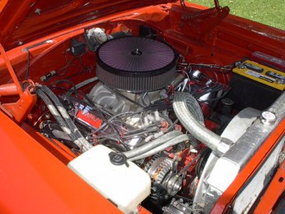

passenger side upper rad support...You can see one next to the rad, the other is basicly below it, the relay should be in the same area
