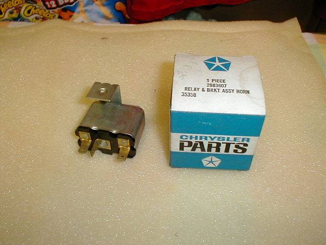

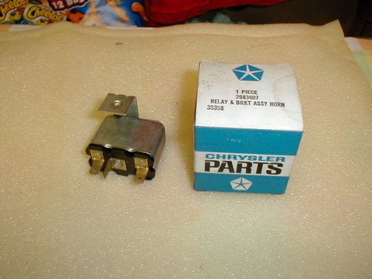

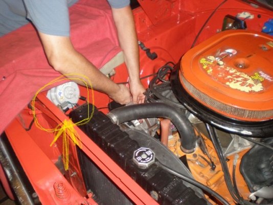

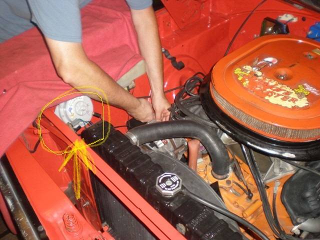

Yes, our cars were born with horn relays. Mounts on the radiator support:
(As you might expect, there are other threads on FBBO addressing these....)
The rascals are available all over creation, both NOS and aftermarket. They're parts
store parts really. Don't cost a whole lot.
Some vendors sell a repro wiring harness for 'em too.

The relay is tipically mounted close or into the fuse block OR like some other models at radiator core support close to the alt. NOTE, IS CLOSE TO THE ALT AND NOT TO THE BATT, as must be correctly sourced every regular accesory, on alt side and not to the batt side. These two locations are close to main positive sources ( fuse box and alt post ) adding EVEN MORE simplicity to the wiring, being a short wire paths to feed the relay from the power source
Agreed with moparedtn... the horn switch being a ground trigger for the relay won't get any kind of load. The load is running throught the relay. The ground for the horns itself is via their own chassis. This adds more simplicity on the wiring.
