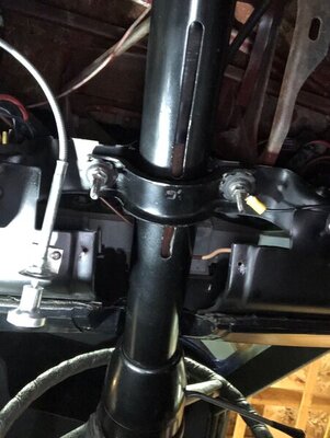

Thanks for that. That's definitely not what the bottom of my column looks like. There is no ground strap or any hole that would suggest a missing strap. Someone ran a ground from the column mount to the dash shell that's it. Is this a B Body / 69 GTX column? I can drill a hole in the column and try a ground wire. Worth a shot.
whelp.... I think I have a 65 Dart / Valiant steering column. Will the surprises never end. Think I can make this work at least temporarily?

here the ground strap on diagram
Is just a plain and basic 16 gauge wire with two eyelet terminals to set a ground between bracket on body and column itself. It can be home made althought some ppl sells those around.
The ground strap is a reinforcement for the column ground but the colum itself still gets diff ground paths along the chassis assembly.
the bearing also gets a staple since 67 for a ground path
Great info thanks. My column definitely isn't a 69 but the ground strap is simple enough. I do think I need to ensure this thing is intact because it is the source of continuity between the black wire and the harness/switch correct?
