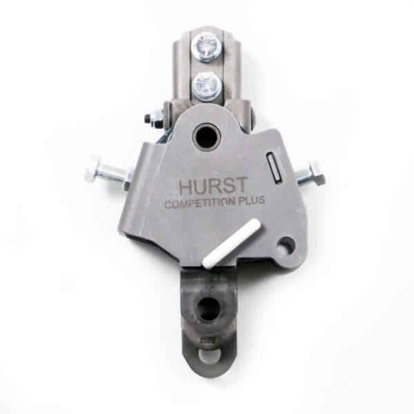

Alright, I might be exaggerating a wee bit. But I’m having sloppy shifter problems, and it’s annoying and embarrassing me, and I’m tired of it. I have an old Hurst shifter mechanism on my 68 GTX, if you can find first gear you have to punch the dash, and then go a little further to get it. Second gear you need to ask the back seat passenger for a hand, and then it’s back to hunting and punching the dash for 3rd, then right back to the back seat for 4th. That might be a bit of an exaggeration too, but you get the point. One of the biggest problems is finding first and third, stop at a stop light or a stop sign looking all cool, getting ready to take off looking cool…and ooh fecal matter that’s 3rd! Dang it, now I look like a chump!
So my question is, would buying a new shifter mechanism like this one from brewers change me from a 0 to a hero?

I really like the new Hurst Competition + shifters. I replaced my original rebuilt ones in both my B-bodies with them. The positive stop bolts take up any excessive travel once you are in a gear. Only downside is you will have to drill holes in your handle to accept bolts, or find an aftermarket handle you can live with.

I just put that same shifter and new handle in my 73 from Brewers and it made a world of difference. I assume my current shifter with slide in handle was worn way more than it looked. I may have the old one rebuilt just to see difference in the way the two different designs work. You will know for sure then just how worn your tranny is.
