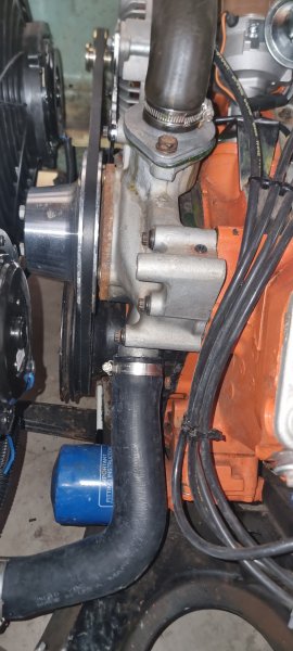

I will tell you my experience put a bigger water pump pulley on it to increase the speed of the water pump. I had a customer we built a 512 stroker on pump gas, for a 4x4 truck and he wanted a serpentine belt system. The engine ran hot, swapped out radiators, high flow pumps, even took the heads back off and opened up the coolant holes in the head and block, changed to a bigger pulley problem solved. just use a stock A/C water pump. From your picture the pulley looks small to me.

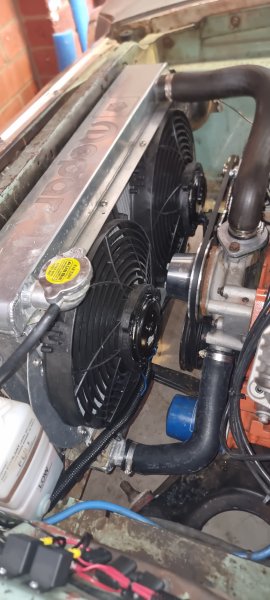

Get rid of the electric fans. Put a good Clutch fan on it and a fan shroud then put a 180 degree thermostat.

Temp rising on the highway equals insufficient airflow. The electric fans are undoubtably limiting airflow. Is your radiator support to hood seal in place? Lower splash pan to radiator support seal in place? The factory setup is to trap air in front of the radiator support, the clutch fan pulls the air through the conical shaped shroud through the radiator, creating a vacuum, which “funnels” the air through the radiator. Your fans are blocking that process.
^^^^^^^^^^^^^^^^^^^^this ^^^^^^^^^^^^^

I will tell you my experience put a bigger water pump pulley on it to increase the speed of the water pump. I had a customer we built a 512 stroker on pump gas, for a 4x4 truck and he wanted a serpentine belt system. The engine ran hot, swapped out radiators, high flow pumps, even took the heads back off and opened up the coolant holes in the head and block, changed to a bigger pulley problem solved. just use a stock A/C water pump. From your picture the pulley looks small to don't
Probably not the answer you were looking for..... but it's the RIGHT ONE!
I have two electrics fans on one of my cars, ONLY cause the radiator is mounted at a 30 degree angle, and there's no shroud available.

Advice about fans and shrouds is sending you in the wrong direction. Those are solutions for low speed and idle hot run conditions. You can run a car with NO fan or shroud at all at highway speeds and remain cool because the air flow through the radiator is waaaaaaaaay more than any fan+shroud can achieve.

Yep! Flowkooler water pump on my 512 with no overheating. Have AC and use a shroud and 7 blade fan. Don't need electric fans. As others have said, you can run at hiway speed with no fan. Those things are blocking air flow. JMTC. ruffcut
There is no radiator lower support seal or radiator support to hood seal. Will look into buying some type of seal and see how that goes.
Just a thought, the car has a reasonably large trans cooler right in the centre of the radiator, with an air gap from radiator of a few inches. Anyone think this would be causing enough restriction to cause over heating? Have thought about trying to relocate the cooler but not sure it would make much difference.
