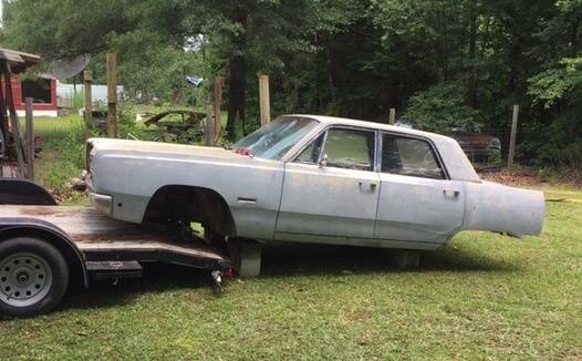

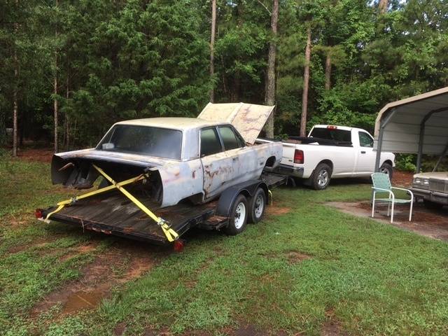

I just pulled this Fury up on my trailer using the winch. No front tires & the hubs disconnected as I sold the disc brakes off it. I was hauling it to a shop to vpcut the floors out to use for my 300 Chrysler so I didn't want to damage anything. Had it high enough to slid ride on with the cars frame

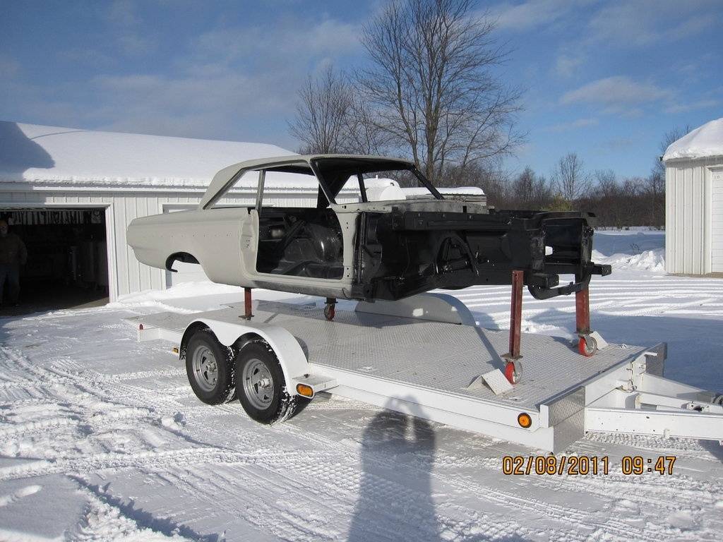

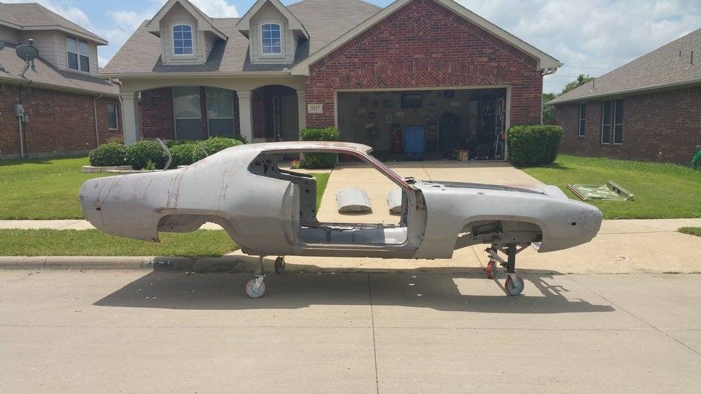

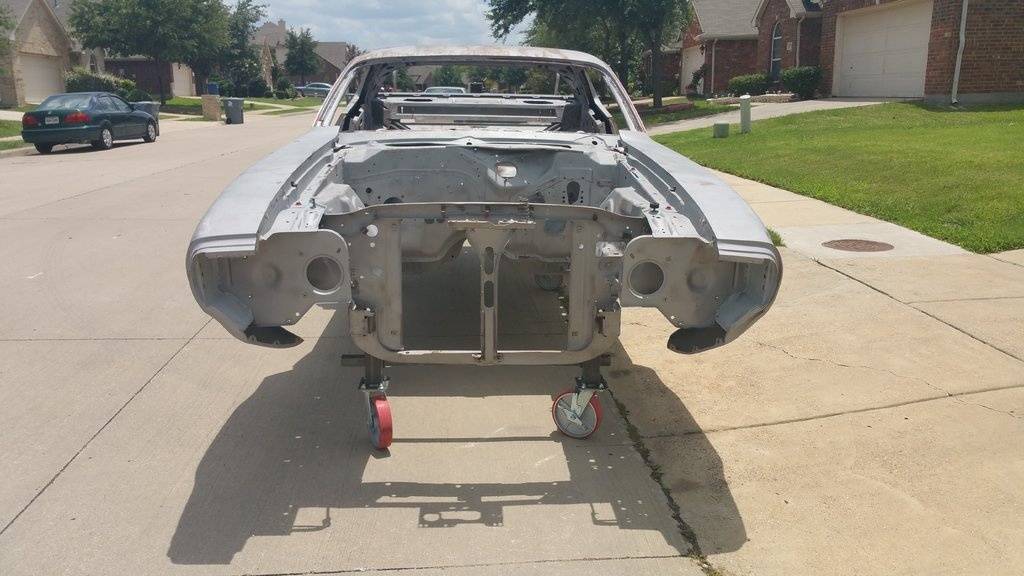

Hi Wizard,
Look at my 65 on the trailer. I fabbed 4-3" angle iron legs with plates and casters that bolt on the rear at the front spring attachment and on the front at the bumper bracket attachment point. The front has smaller angle iron located and welded parallel to the ground to stabilize the front legs. I can spin this car around inside the shop by myself.
Mike
Hi Wizard,
MikeView attachment 442215
This is another good idea. How does it move around on the grass? I may have to get bigger wheels as I will not be rolling it around on a flat hard surface like concrete or anything. I would be moving it on the grass/soft dirt. Possibly I could get some bigger wheels at Harbor freight or rig up a straight axle on the back with some old lawn mower wheels. The front wheels I can put tires on as I have hubs on them.
Thnks for the ideas. Keep them coming

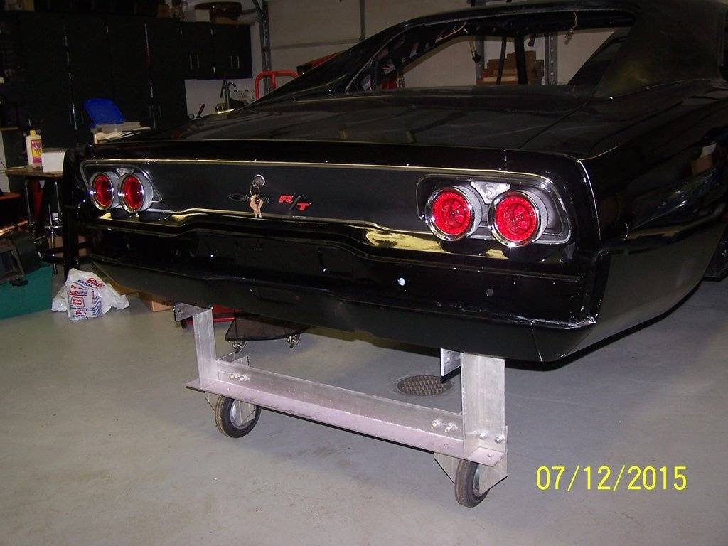

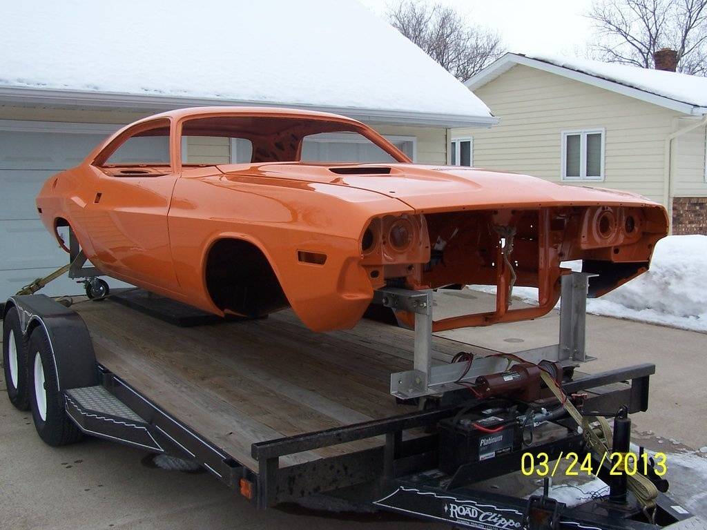

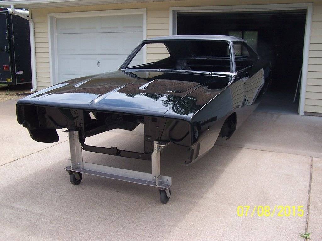

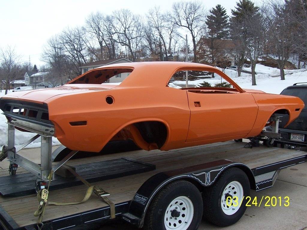

Here are some pics of what I made for transportation. I used some scrap 1/4" X 3" aluminum angle. I had to change a few things to make them work on different bodied cars but they worked great for me. I used them on 2 Challengers and my 68 Charger. Just sold them at a swap meet last month.
View attachment 442249 View attachment 442250 View attachment 442252 View attachment 442253
This is getting better and better. I like what I see there. I just need bigger tires for it to be moved around on rough terrain. Will not be moving car around on blacktop or cement.
I got these from summit for about $275 and they work great. If you needed too, you could probably modify 2 crossbars and extend the wheels further out if you needed since mine are kind of close together. My rolled pretty easy on grass and gravel but it is also, just a light shell.
I believe they are 8 inches tall x 2 inches wide.
Okay, was just shopping Home Depot and Harbor Freight on line. They sell solid polyurethane caster wheels (home depot) from size 10 in to 12 in diameter. That should work. Can mig weld some metal to them and bolt them up.
I makewhat I call "magic legs" using stel scrap and Harbor Freight casters all the time. I think I have 3-4 sets at this point b/c everything is torn apart...lol. Get the largest diameter wheel you can if it has to roll on dirt or up ramps/transitions into garage, etc.
