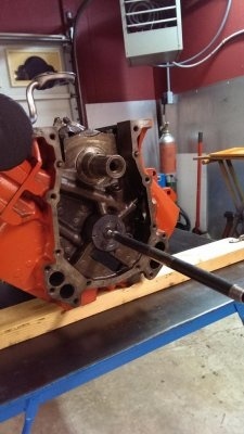

Just did mine not that long ago and with my home made installation tool, I could turn it quite freely with the tool.

I didn't want to say anything because I always got a bunch of push back whenever I said anything about having a home made cam bearing tool too. Made it about 30 years ago and never had a problem installing cams again. Most shops want to do the bearings and freeze plus whenever you have a block cleaned and I have a hard time getting them to not do it even when I tell them I'll pay the same price so now a days if the block isn't too nasty, I'll clean it myself and avoid the hassle.

On inspection with my build, I could see the distortion, on the leading edge of the center bearing, caused by the installation tool. It was definitely a high spot. I rigged up a rod with a fine stone and worked it out. I took all the precautions that I needed to keep any metal particles out of the oil port and the block. It pisses me off, having to fix something that someone else should have taken more care in doing.
