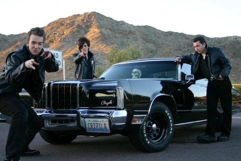

Perfect cruiser! You want a stump puller, get a tractor! Crizila frt qtr view.jpg

Crizila,
Nice car!
