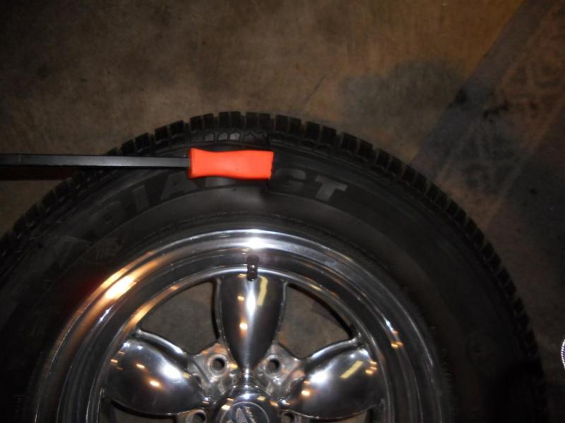

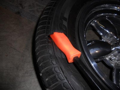

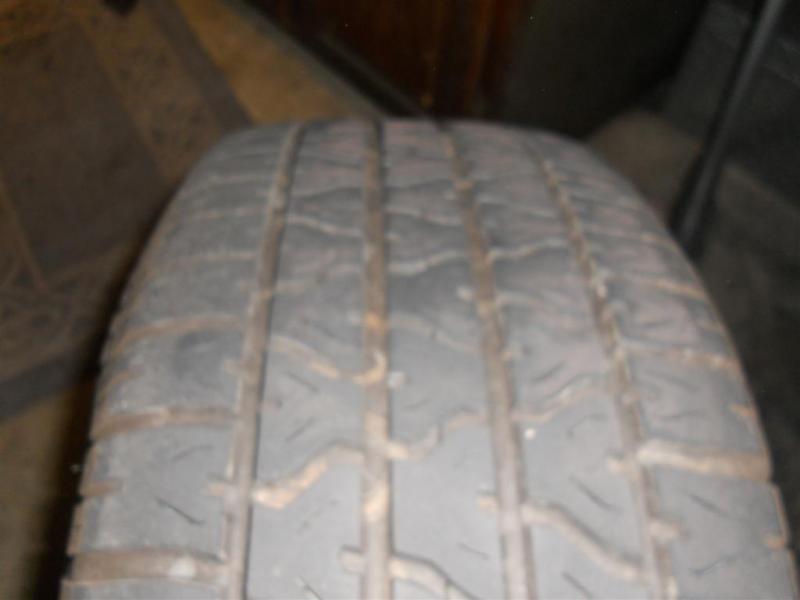

Took the 67 out to cruise night tonight, and as usual, when I am traveling solo, I tend too be a little heavy on the loud pedal. After the high speed romp on the interstate, I took it easy on the 2 lane highway section of the run, only to be rewarded with a tire failure. As I pulled off the busy road at 9PM, I said some thanks, as the tire didn't let go 10 miles earlier, then began cursing myself for not having the jack back in the car. A quick call to a buddy who was behind me coming back from the cruise lot got me a ride back home, but no jack. Just as we were about to leave the car, a guy in an old Vette pulled up behind us and had the needed jack. After I got home I looked at the tire to find a 1-1/2" gash in the sidewall and another soft spot in the sidewall a few inches from the gash.No dry rot between the tread. The date code on the tires put them at about 10 years old. I bought them new when I got the wheels at Carlisle in 2003. I had seen on 60 Minutes last year a piece on replacing tires that were at least 5 years old and kinda dismissed it as BS. Now I'm not so sure, but I will be purchasing 4 new skins before the trip next month to PA. Any thoughts, thanks....... Here's a little **** for everyone who bothered to check out my post......

tire"life"do to age is very dependent on how they are stored.if not exposed to sunlight and with no load on them they will last a very long time.that being said,i would never run a tire over 5 years old.i have seen far too much body damage due to tires comming apart older then that.as to the original post,that appears to be an impact break.you must have hit something in the road.due to the age of your tires it burst rather then just going over the object most likely.i have been in the tire industry for more then 20 years and the common brands differ alot.
