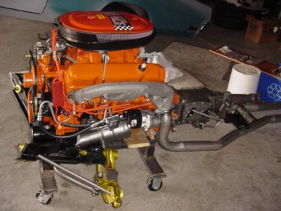

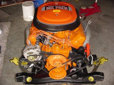

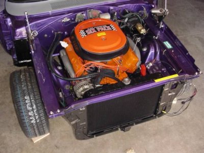

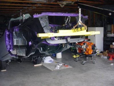

For all the trouble and worries of scratching/etc... I would drop your suspension & put the engine on the K member & come up from the bottom. I got mine in with the exhaust manifolds bolted in place even. Not much room but it goes! :headbang:
