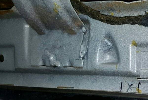

One of the roof rails on my '62
The 67 has remnants of factory MIG welds.

K-frames were definitely done with a stick - the flux is still there to prove it. Anything that was migged was done VERY poorly HOWEVER, if you've ever tried to weld 18ga sheet metal, unless you use fine wire and low settings, you won't do any better regardless of how good of a welder you are. From the looks of it, the factory used fairly thick wire and the heat to go with it. Considering that guys were probably just handed a mig gun and told to point and pull the trigger, we should consider ourselves lucky that a) most of those welds held and b) there isn't a hole blown through at each weld point.
All I can say is I really hope people aren't trying to replicate that!!:eek:
