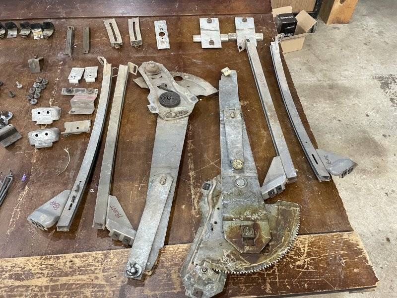

So let's begin with what you need for 1 door;
- The door glass itself with the up stops installed (a note on this, if you buy new up stops they come with black round rubber bushings which I believe is for later glass with large holes, on my 71 the stops fit the glass without the rubber)
- The window regulator (needs to be in good condition with all of the nylon guides present)
- The regulator pivot (this is a rectangular plate with a track to channel on it. The channel is mounted off center and IMO the long part goes up)
- The window tracks: front and rear (1/4-20 bolts x 2 for each on the top which are about 1/2" long but can be longer, there is a plate/bracket that goes on the top which also serves to locate the door panel and a square head bolt on the bottom with fender washer and nut)
- The 2 guide rollers (these are 2 nylon bushings with screws in them, they are used to keep the track on the glass)
- 2 up stops (these have rubber on one end and have a stud with a 1/4-20 nut). If the rubber is lightly damaged you can cover it with some 1.5" heat shrink rather than buying new rubber.
- 2 window guides (these are the L shaped pieces with the fuzzy material on one end. They are used to guide/push against the glass slightly helping to "guide" it in the correct arc. Note here, do not get lubricant/grease on these or you will forever be trying to clean your window and every time you roll it up you will have a streak)

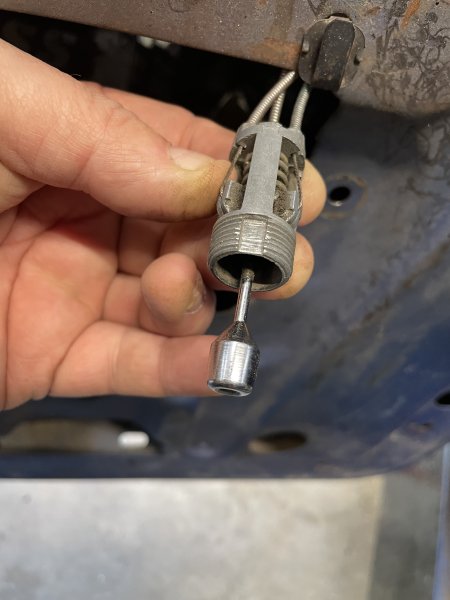

On the drivers side you MUST but the door mirror on before installing the glass and routing the remote cables (it runs to the front in a U type configuration and has round clips to keep the cable from hitting the glass, if the clips are missing you can use something like a Mag daddy to replace the clip). Once the glass is in there is zero access to the cable/mirror mainly because you use the hole where the regulator is mounted to reach and guide the cable.

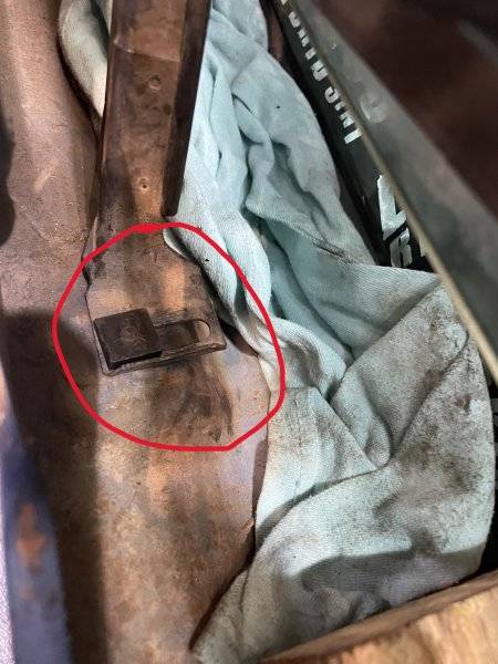

Also you need to secure the door lock rod in the upright position. There is supposed to be a clip with a loop in it that keeps the rod upright, again if this is missing I would suggest using a Mag daddy to replace it.

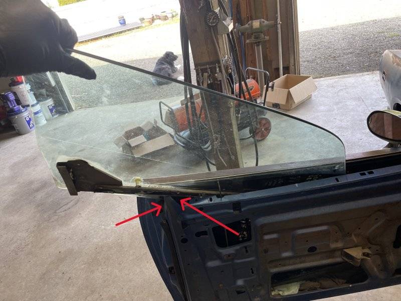

- Slide the glass into the door. This is the tricky part in that you have the basically slide the glass into the frame at the back of the door nose first and sort of "submarine" it into the frame in sort of the angled sweeping motion. NOTE: looking at the back of the door just behind the door lock rod and the back of the door frame there is kind of a slot or an angular opening, this is where the glass can slide in, however you need to tilt the glass inward (towards the inside of the car) as you try and get the glass in. Once you have the glass inside the door frame, scoot it back against the outside of the door skin (so there is a gap between the glass and the regulator).

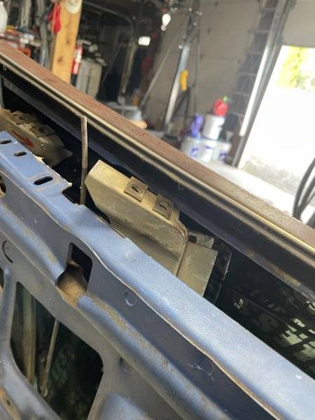

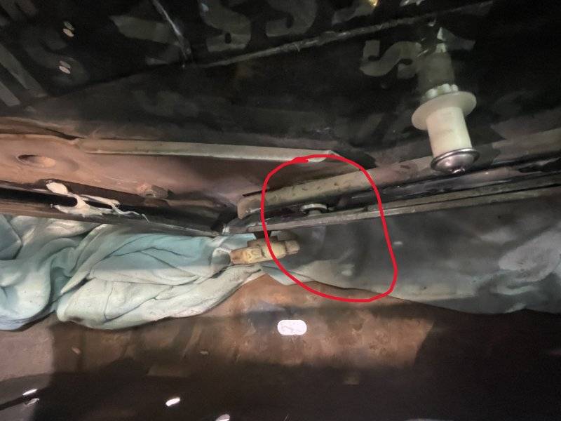

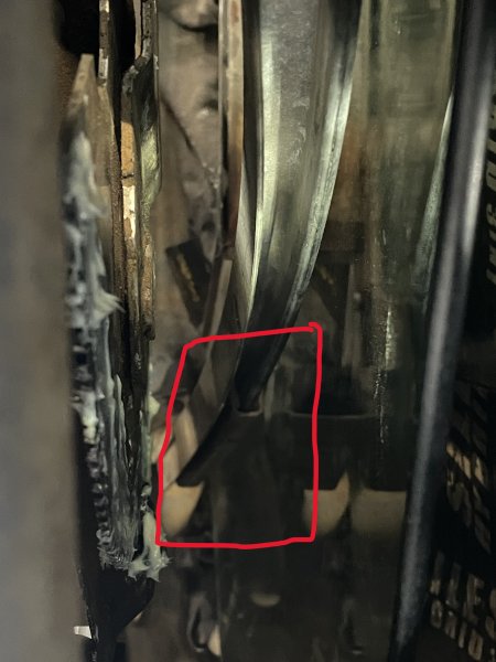

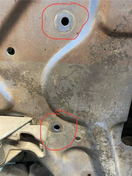

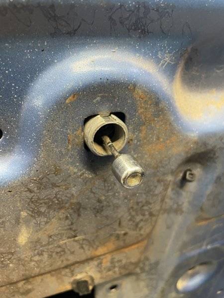

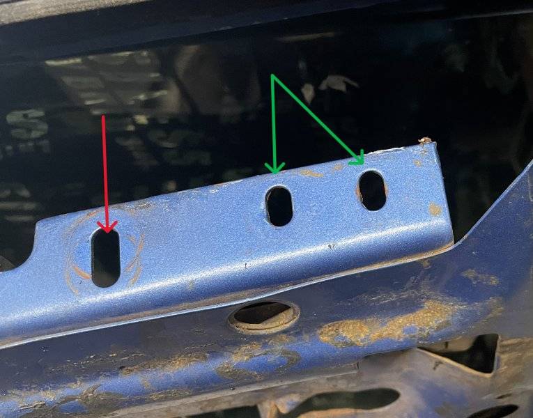

- The 2 square holes on the top of the door frame are for the window tracks
- The 2 slots on top of the door frame are for the window guides (fuzzy brackets)
- The regulator is held on by 3 short 1/4-20 bolts

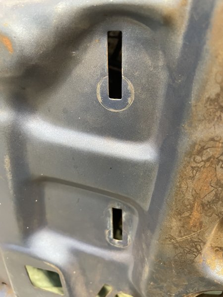

- The 2 rectangular holes with the slots on the inside are for the window stops (brackets with rubber) These should be removed prior to putting in the window.

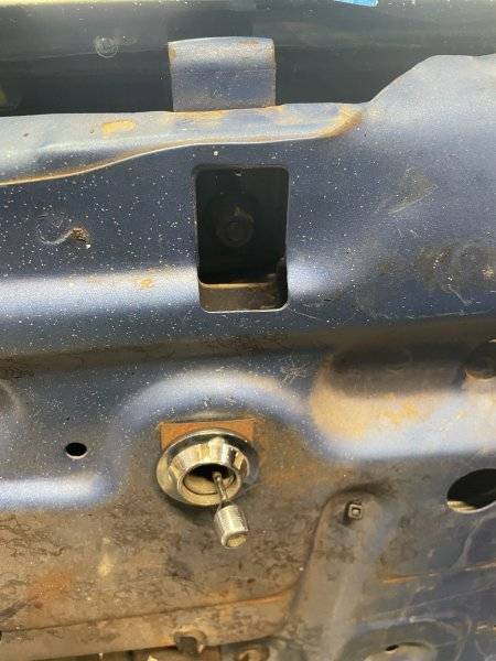

- On the drivers door only there is a square hole with a tab above where the window crack would be and slightly to the right (looking at it), this is where the window adjuster goes. The cables MUST be routed and held along the perimeter of the door or they will rub on the window

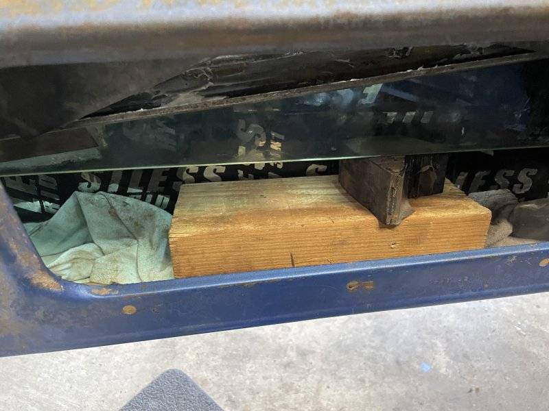

- Get some pieces of 2x4 or something handy, reach in towards the center of the glass and raise it approximately 2 to 3 inches (NOTE: pay attention to the top of the glass and make sure it is not hitting the inside of the door frame which will prevent it from going up), put the 2xx4 under the glass to keep it raised up.

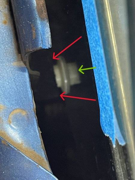

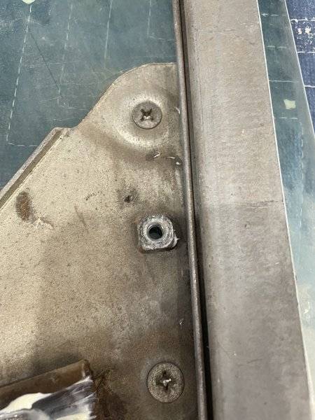

- At this point get down and look for the square nut that is on the window frame which is where the track retainer bushing will fasten. You might have to raise or lower the glass a little but you want to get that bushing in because it will then keep the track and glass together as a unit.

- Once you get the track and glass mated you want to focus on getting the track retainer bushing installed. This can definitely be a PIA because you are going to be fighting the weight of the glass and everything being loose. You can and probably should drop the square bolt into the bottom hole for the front track and get the nut on it, this will help some in keeping things from moving too much. NOTE: You might have to get inventive to get things aligned or get enough space to get the bushing in, DO NOT beat on anything, you can apply pressure in various directions using preferably wooden rods/poles but remember you have metal and glass here, hitting anything will not yield any positive results.

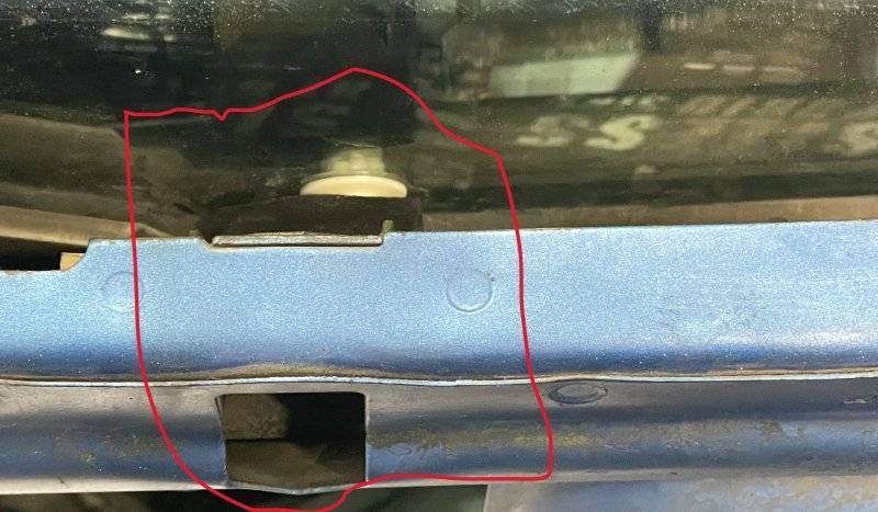

- With the window down, install the up stop brackets and the guides loosely
- Raise the window up and snug up the various bolts. Lower the window (not below the window weather-strip), if it is tight loosen the lower track bolts. Do this a few times and the window will somewhat center although this doesn't mean this is where it needs to remain.
- Raise the window to what you think is about 3/4 the way up, close the door and see where you are. Keep doing this until the window is in position (high enough) to seal against the weather strip.
- At this point you can set the stops by loosening the nuts and sliding the stops down to the glass stops.
