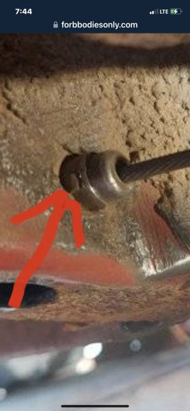

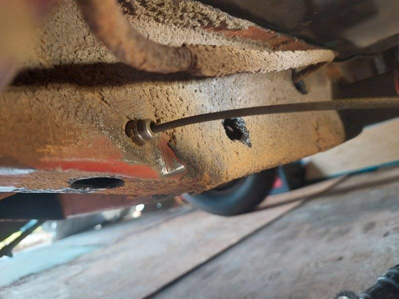

1970 charger I have the pedal removed but how does the housing come out of the frame rail? Everything is disconnected.
lol........ the secret is right there, you need to scrape a little undercoat to find it :poke:
That BITCH of a cable retainer !! It'll fight you just as much to install a new one !!

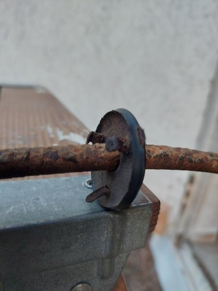

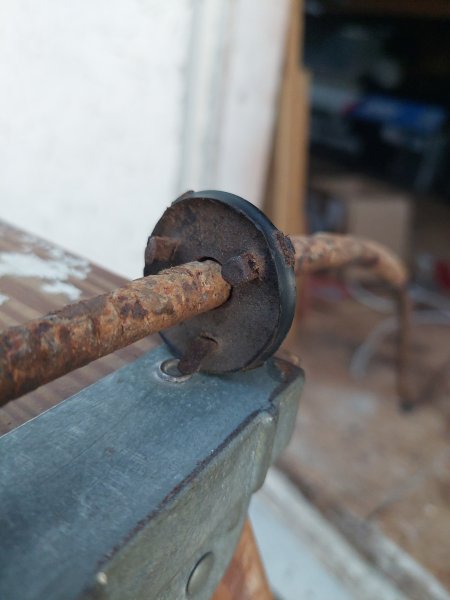

figured I need to post pic of grommet in firewall
I would make every effort to save and reuse that grommet !! Cut the cable off wit a zip wheel about an inch away so you don't have to pull it very far to get it off. Clean it up and reuse it.
