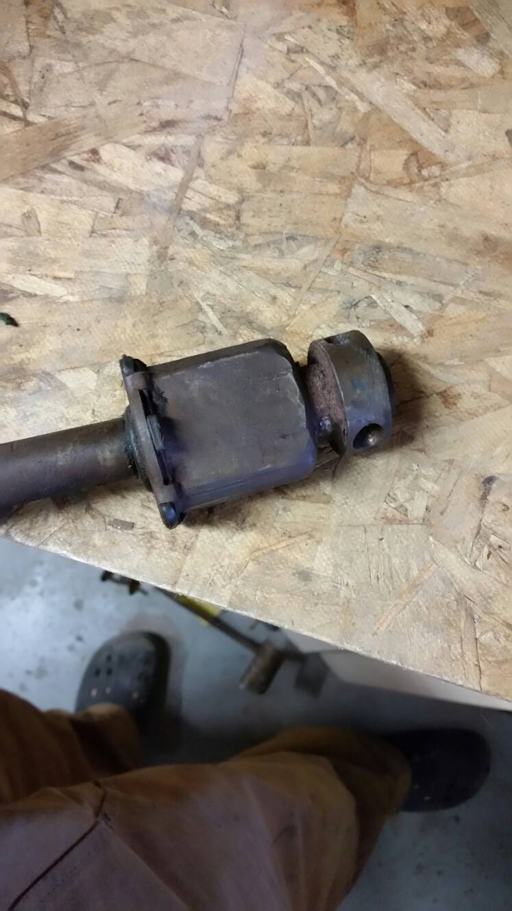

Hey there hows it going to all. Happy Easter. Ok so I'm in the process of my resto on my 66 and now working on my steering column. So I need to replace the lower steering column seal but I see in order to do that I have to remove the lower steering coupler. Can I please get some help on how to do this? Is it pressed on? I've included links with a pic of the seal and coupler. Thanks in advance
To remove the coupler pry out the four tabs on the seal retaining ring and the coupler will come off along with all the parts inside and then you will have to press the pin out of the shaft to get the seal off.
