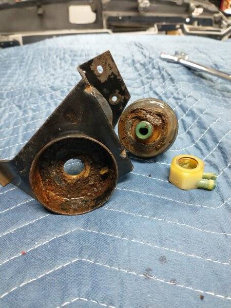

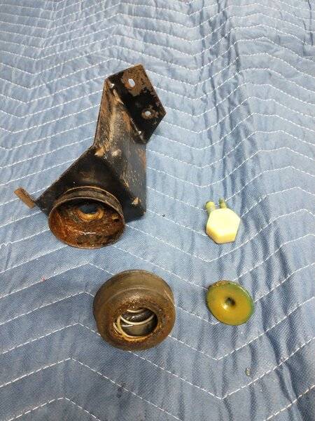

How does the disassembly go? The FSM just shows how to remove/replace the assembly in the car.
Working on a 70 Cuda with manual foot pump.

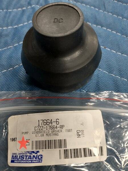

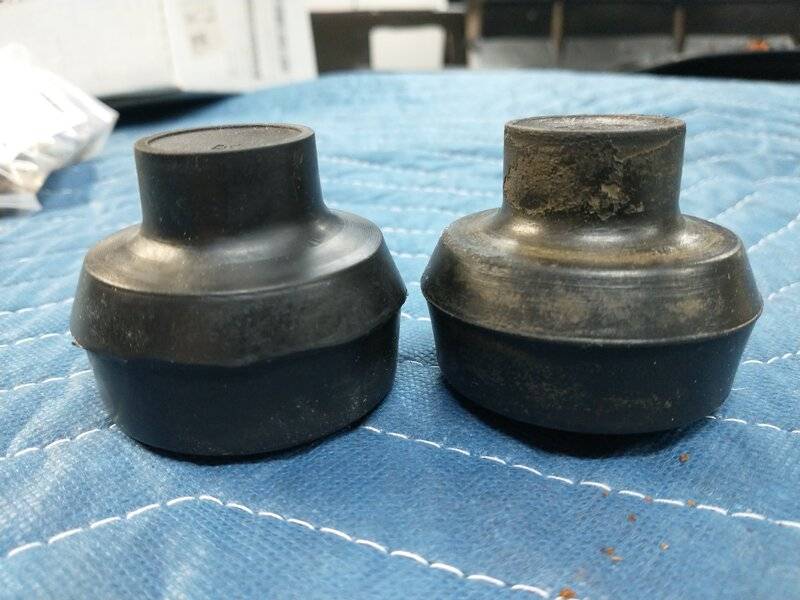

Also, does the Ford replacement rubber fit a Mopar pump? Below is the one for sale for a Mustang.

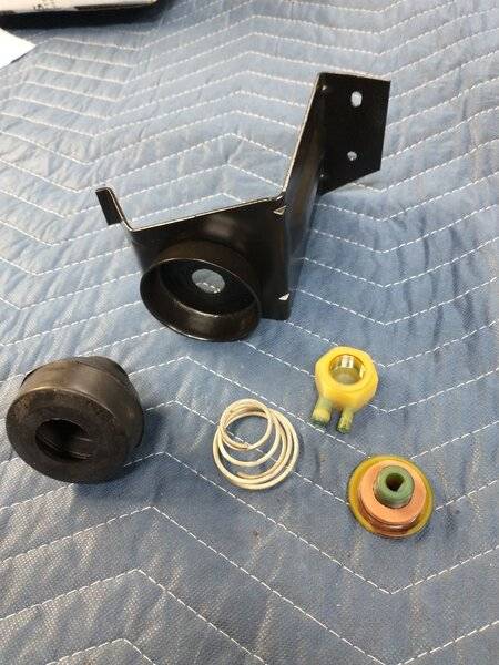

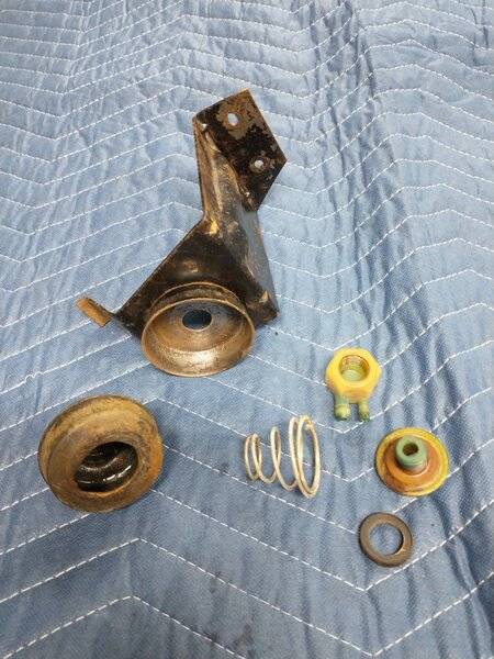

I took a chance and unscrewed the plastic valve using a 1" wrench and it didn't brake; Thank God!
The rest was easy.
I just did my '63, I may have some pics of it. Chances are, I won't be using it, as the bag may be too close to the Ele Ears ?

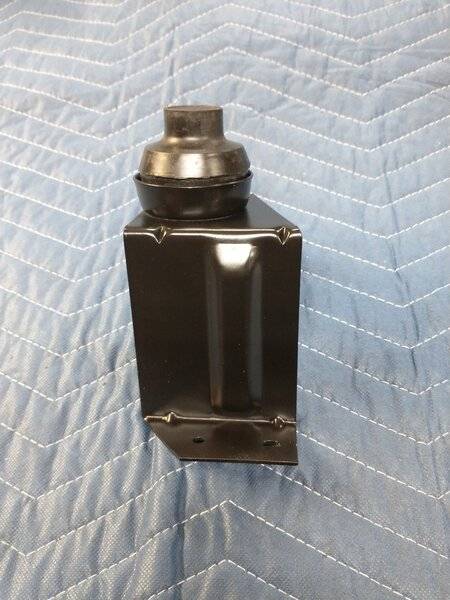

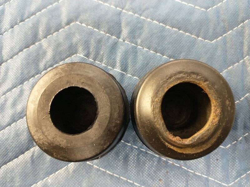

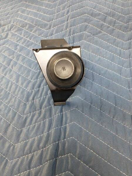

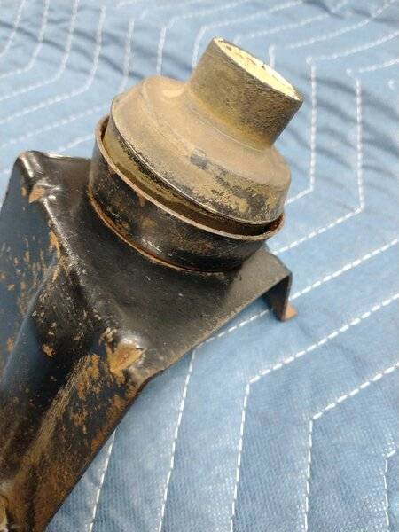

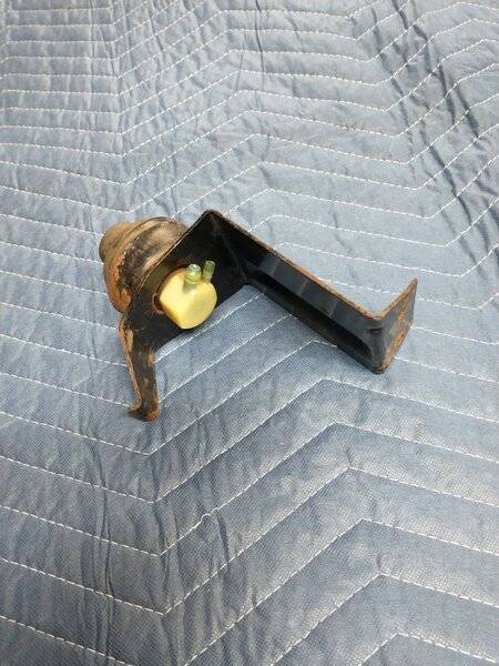

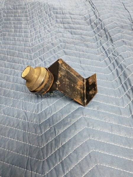

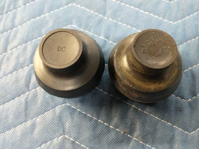

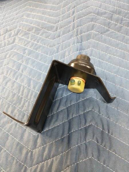

I received the rubber part from National Parts Depot and finished reassembly of the manual washer pump. I used a garden hose gasket and a bit of silicon grease on the plastic threads and under the rubber as it is self-centering. I left a review on NPD letting them know this is exactly the same rubber part as the Mopar uses. So, maybe they will list it for Mopars in the future.
