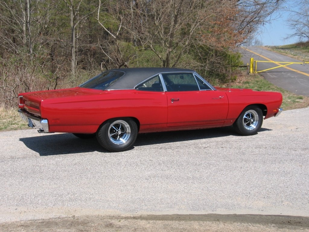

I have 275/60/15 on my road runner with 8" wheels 4.5BS,pleanty of room with the stock ride height,

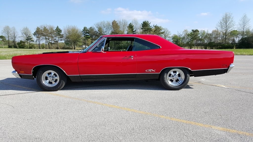

nice ...seems my springs are original and weak but I still think it should work..wish I could post a pic of mine but can't seem to upload it
I got a set of hoosier quick time pro slicks from a buddy with 275 50 15 and they fir great with 4.5 backspace..my springs are weak and original..need new ones
car went 8.42 in the 1/8 mile not bad 3.55 gear
I like where the rear is at for height! Good looking X, and runs good too.
