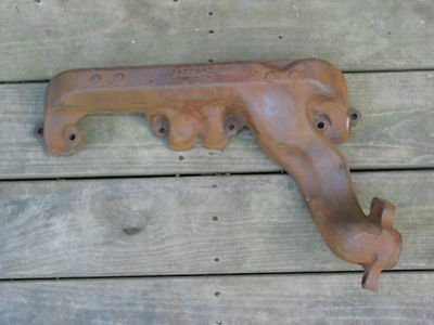

I don't think there was ever an HP manifold for the 273, period. I know that's been a point of contention with the A body guys. Because they think that bastard lookin driver's side manifold that points back is a sign of HP manifolds, and it's not. That's how they all were. I think the only HP "manifolds" ever offered on the 273 was on the D Dart and they were headers made by Doug Thorley. I believe even the 273 Commando had the regular manifolds. Some may argue that, but I think it's correct. And there's absolutely zero reason to have ever offered an HP manifold for the 273 in a B body. I mean really.
Here's the driver's side A body manifold everybody thinks is an HP, but you can plainly see the ball mount. All the ball mount manifolds had small outlets.
The ONLY small block HP manifolds that I know of came on the 340. But even the drivers side looks like the standard up swept 318 style. I think it's just larger is all.

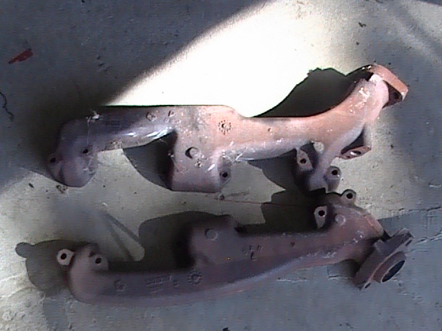

I was going to suggest using dakota manifolds. I believe they flow as well as 340 manifolds and are a lot cheaper. I run them on my '70 Satellite. They dump closer to the floorpan, at the rear; but it works out well.
They do, especially the ones with the 2.125" outlets that came on the early 90s Dakota R/T and Rams.
