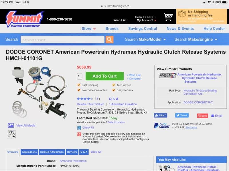

I just can’t figure out how to launch the car with the current collection of parts. I hope this is the answer. Sales tax now too for out of state purchases.
I have been looking at that kit for a while. You can get it cheaper at American Powertrain, then have summit price match and get the free shipping on top of it. You may get a racer discount too if you call them and ask for it. I think I have found it for 450-550ish through a couple different sites.

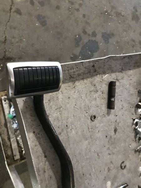

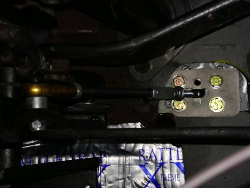

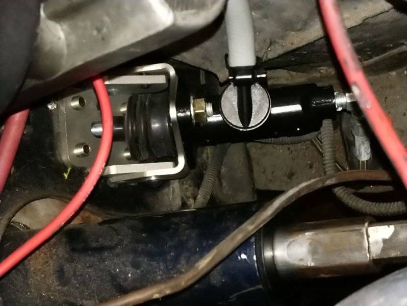

Ask and you shall receive. The worst of it was drilling the pedal for the heim joint. I wouldn't recommend trying to do it in the car. A drill press would help. The other thing is reinforcing the firewall. I just used panel adhesive and rivets to add a piece of 16 gauge sheet metal on the inside of the firewall. Should hold up alright. If you are gonna really wail on it often further reinforcement may be in order.

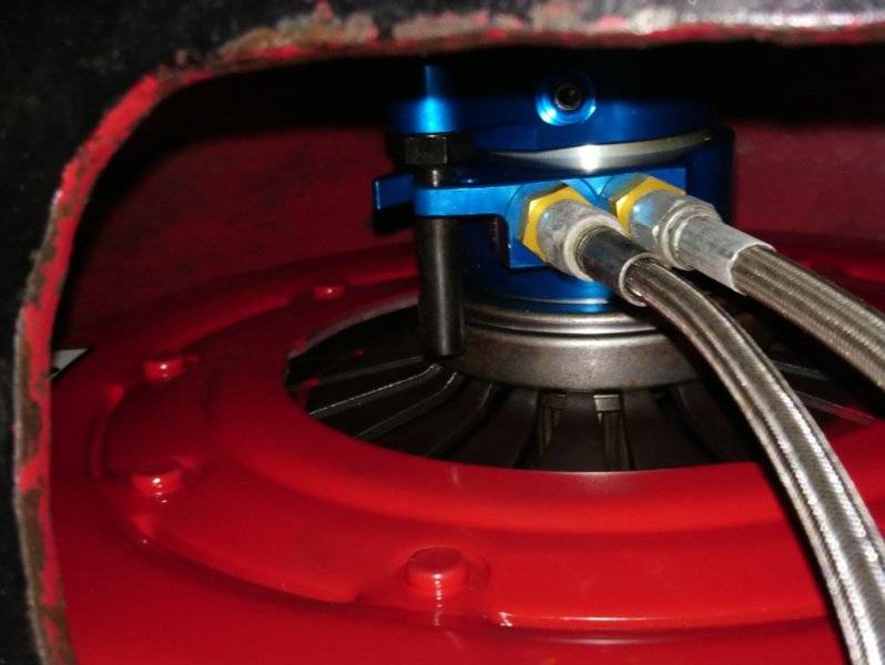

I've had this unit in my car for over 3 years in combination with a Centerforce Dual Friction clutch. Works flawlessly. BTW, Steve, there is no slave cylinder. It's a hydraulic throw out bearing. Very clean set-up and no worries about header clearance, etc.
