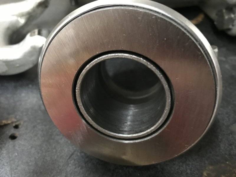

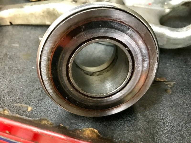

Throwout Bearing. Tech says inside machining that rides on shaft looks rough. New one the same. 1000 miles. Old on top.
The TB shouldn’t be moving except forward/backward. Spinning means that a bolt got sheared off.
Is that a hydraulic TB?

Done. Got it. All is well. Clutch is light and engages where I like it. No chafe or chatter. Pedal returns on its own. Theory is that old heavy clutches required an over center spring to help reduce pressure. With a light modern clutch it works against that and can cause pedal to not return fully. Throwout bearing replaced. Unique to SST and wise to have a spare. Not the same as the 833. Easy to launch and drive.
