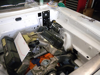

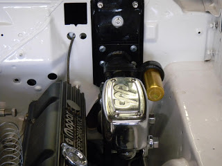

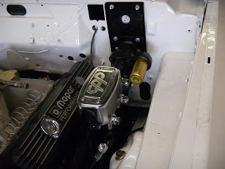

I posted this earlier today in my build thread. I figured not everyone would see it and felt like it was significant enough that people would want to find it. Here is a picture of the hydroboost setup on my car. We had to make the bracket from scratch to fit a b body. I kept the template so I can make more. As you can see it fits with tons of room. It is easy to get the valve cover on and off, even on my big block. I will update this thread with pictures as we route the hydraulic lines and finish off the brake system. If there is any interest, I could build hydroboost kits for B bodies.

The hydroboost itself is about $540. You can buy a aluminum corvette master cylinder for $80. The lines will run you about $200. $540 includes the B body specific bracket.

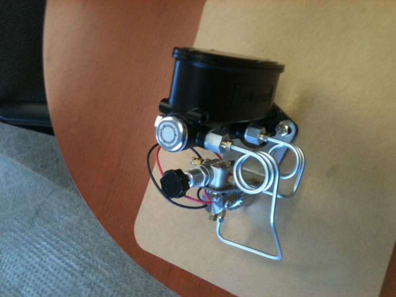

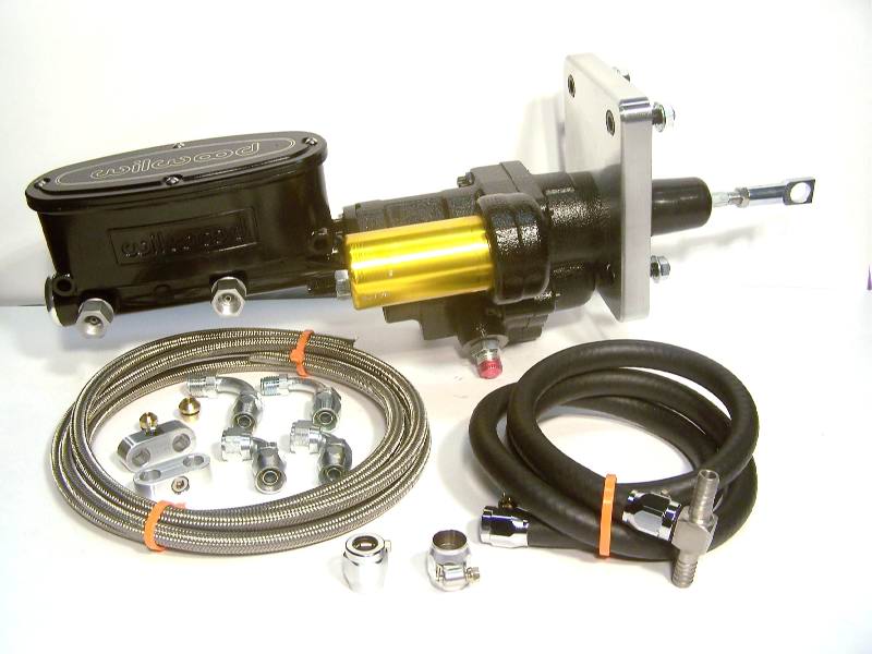

check out this bad boy ! ! what do ya Think Killer or overDone ? About $1200.00 comes with mounting plate for hurst line lock, wilwood master,wilwood proportioning valve,new hitachi hydroboost,new aluminum adapter plate,and hose's

SO I have driven mine a few times now. This thing FRICKEN STOPS. It is crazy how hard it stops. I have some tweaking to do, but it stops nearly as good as my 2012 Chrysler 300 Mopar Edition
**** it stops that good ?! thats absolutly awsome ! ! did you have to change or upgrade the power steering pump ? i order my setup without all the fancy lines or proportioning valve or other stuff so just the first pic that i posted, $825.00 shipped get it next week !
