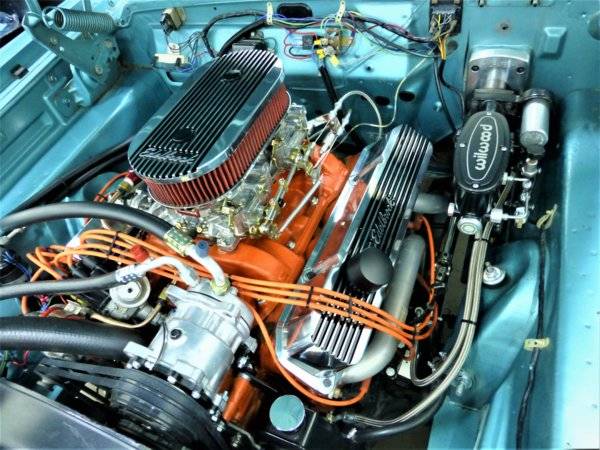

I have a lumpy cam and not much vacuum at idle so went with the hydroboost and Wilwood discs up front and a Wilwood master cylinder. The hydroboost makes the brakes super powerful but the pedal is harder to modulate than a typical vacuum booster set up. Also, more pedal pressure is required than with a vacuum booster, but requires less effort than my previous manual brakes.
I recommend talking to these guys... http://www.hydratechbraking.com/contact.html
They set up my hydroboost, master cylinder, proportioning valve and shipped it as a package all bolted together. The Hydratech guys know Mopars and ask the right questions. I paid about $1300 for the hyrdoboost, billet mounting plate, braided lines, Wilwood master cylinder and proportioning valve. The master cylinder and proportioning valve accounted for about $400 of the total.
I had a single master with manual drum brakes. Never felt safe driving the car hard. Now I have confidence the car will stop quickly when needed.
