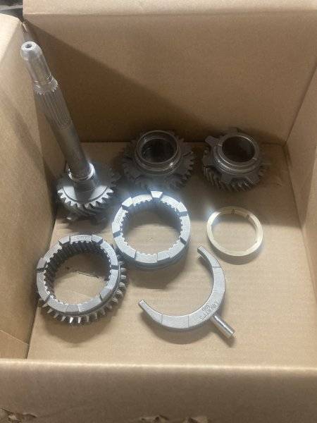

I guess I should think about putting my transmission back in. Ambition became lost over the winter. Now that it has finally started warming up, maybe I’ll find some focus.

This is an upgrade/ Maintenance to the transmission. I had slick shifted it yeas ago, and the gears were finally shot.
The big dogs on the gears are the best upgrade for an 833 and are supposed to last a long time.

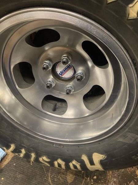

I also got the 5/8 studs. I posted this pic earlier, the deleted it because I realized the studs were going to interfere with the parking brake strut, and I felt like an idiot.
So I stopped at work and put a little racing clearance on the struts.

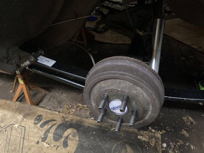

Well, the *** end is ready to go. New 2” longer split mono leafs to replace the super stock springs.
I had to shorten the front hangers, and get new bars for the Caltracs.
New 5/8 wheel studs, and new brakes while I had it apart.

Very much progress. Those studs are one heaping load of assurance.

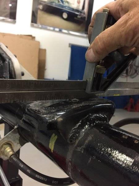

When I found my bent studs, it was at the same time that I found my perches were flattened / curled. My Dana was rocking under there pretty good. Probably had about 10 degrees of pinion angle change. Had only my perches been boxed to start with.. The best I got my car with the cal tracs and QA1’s was 1.38 60’ I switched over to Ladder Bars and haven’t looked back, with 1.30 60’s with the 505.

Pic of my perches. Crazy.

You’ll need negative pinion angle, 4 or 5 degrees. But all of that won’t help if your perches have started to crush. If they’re not boxed, you need to look real close. If they’re not then box them. In the last 3 years there’s been several cars pitted right around me and they all had perches bend. None were previously boxed and their launches went away and were just like yours.
If you see any sign whatsoever of space, movement, dig deeper.

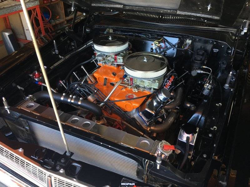

drove the car around the block today getting ready for saturdays local car show. holleys r working great mainly thanks to this thread. a major step up from the carters. back in the day it took these same carbs for the hemi to outrun the wedge as the story goes.
Holley Carbs
also installed the door bars that came with my roll bar kit from rhodes race cars. they lay down towards the back for much easier access.
Holley Carbs
Enjoy the show Stage 3. Hey, you raised the bar lots on this thread with your tuning wizardry. Special thanks from me!
Mike, with a car like that feel free to post wherever you want too. Great looking ride
