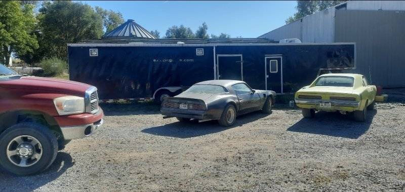

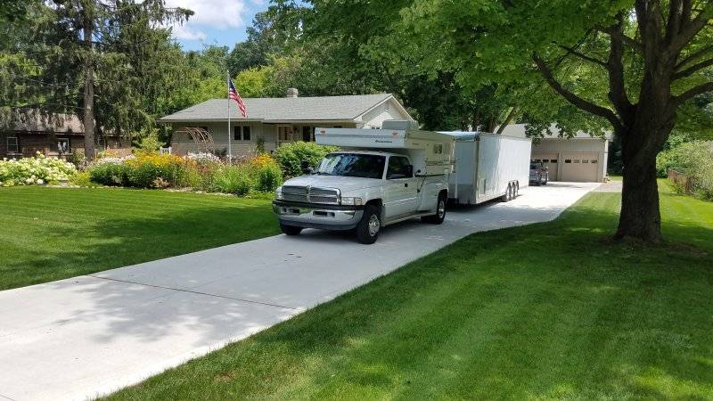

We have a 46' triple axle with living quarters up front. I'd love to get up north to a few races in michigan and the monster mopar event.....but My dodge diesel is getting some miles on it, and new diesels are not in the budget. Possibly have to dedicate a semi for such trips.
I'd love to get up north to a few races in michigan and thr monster mopar event.....but My dodge diesel is getting some miles on it, and new diesels are not in the budget. Possibly have to dedicate a semi for such trips.
95 Cummins, camper, and a 33ft steel trailer.
Doug
We have a 97 3500 cummins 5 speed and it may still be running after the apocalypse.Lol
I have been using my 07 2500 megacab w 6.7, but it only has single wheels. Handles it fine since living quarters are in the front, car sits on the trailer axles...but dual wheels would be nice

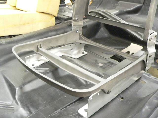

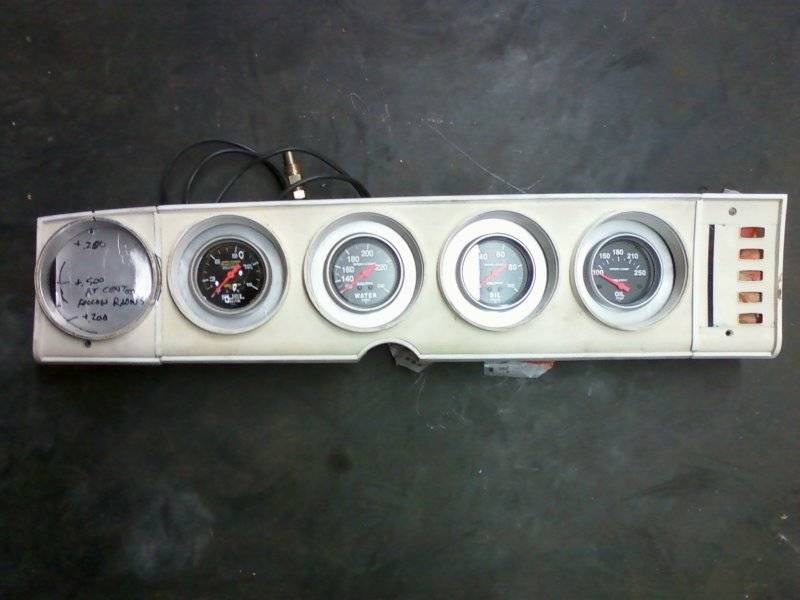

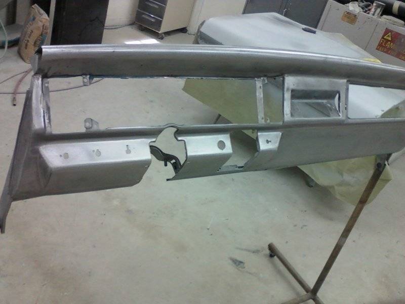

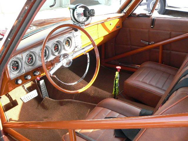

Made these aluminum seat brackets. Each seat weighs 21lbs complete with brackets. The heavy cluster was replaced with 1/8" aluminum to house the gauges. Nothing else mounted to the dash except the shifter and a few original switchs which control tach record, horn, gauge selection.
Doug
Looks great. I love it looking like it could've been born that way. We are trying to decide what to do for front seats. Our superbee had a bench that I bought a new cover for...I know guys have used bench seats in race cars, but I don't know if there is enough support for me. I like the headrests you run. I have them saved on my phone for ideas. But, leaning towards buying racing seats... I guess. Not really the look I want.

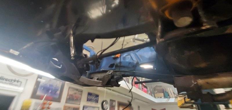

Yesterday's project. Yesterday drove a 318/727/drum brake/ worn suspension/ bent strut rod into the shop. Pic is at the end of the day. Had to heat a drill every cotter pin. Will leave with a 440, 727, front suspension repaired, straightened strut rods, disc brakes.

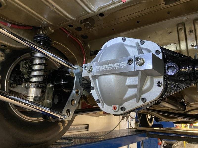

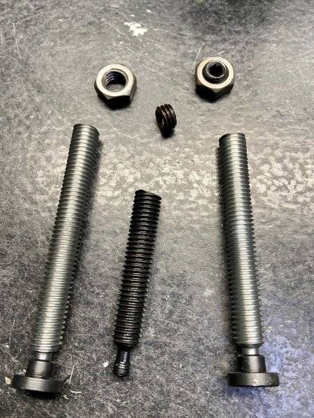

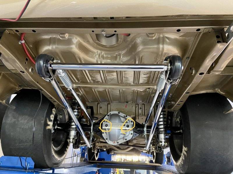

Pulled the Moser diff cover off and did an inspection on things. All looks excellent, bolt torque all good and back together. When tightening the bearing cap bolt support to 60” lbs, I barely got it snugged up and the Allen head snapped off. What the hell. Attempt to torque the other one, same thing. Some pics.
The circled area, both Allen heads snapped off the end of the bolts with barely any force. Bugger

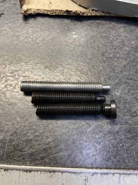

Both Allen heads snapped off the ends. And on the end is left hand thread for the pads. The one of top is my plan for a fix.
1/2” UNC. The new lathe is already paying for itself. I don’t have an indexing rotary table yet, I could have used one for this project.
Back together. Sure overkill for 5’ lbs torque. (60”lbs). Next time apart I’ll machine hex ends onto the new home built bolts.

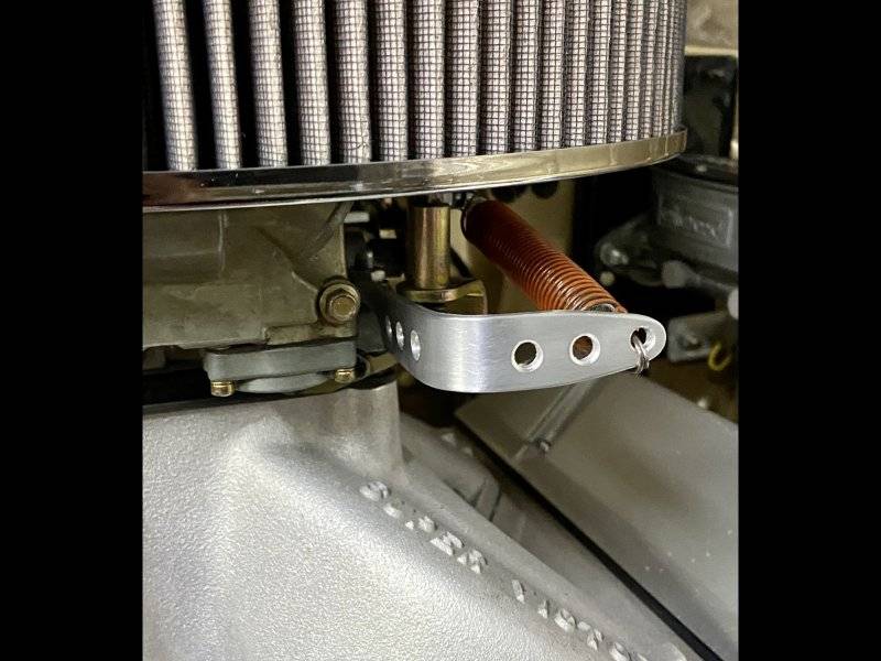

Simple little addition. Aluminum throttle spring hook. Secures on the plenum stud. Doesn’t get much simpler than that. Might have to drill some holes in it to reduce weight..

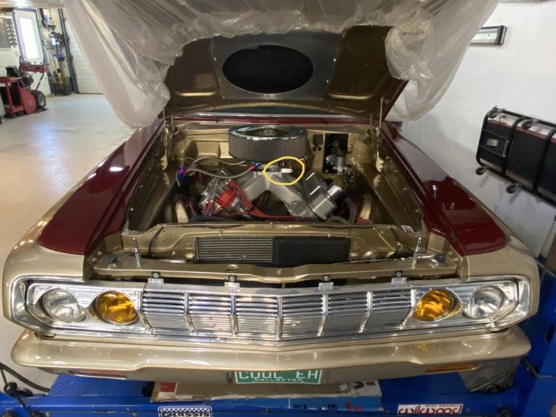

Great work as usual Doug. when did you go single 4?
If these posts are addressed to me I am not running a single 4.
Doug

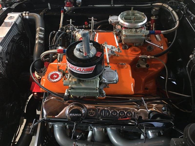

Loads of room to get at the starter but adjusting valves could have a few tight/ hot spots. .
Sort of reminds me of my grandson. Bought a truck. Soon as he got it home he cut the damn muffler off.
they are just for cam break in..sure is easy to get to the spark plugs though

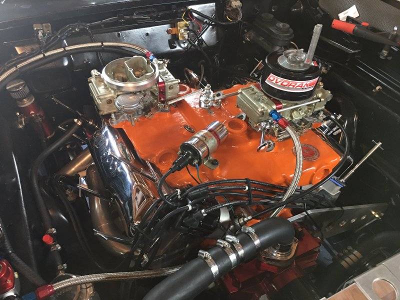

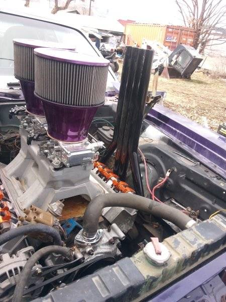

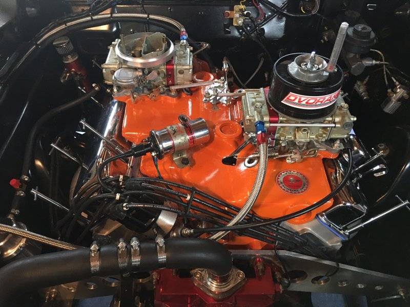

tuning on my max wedge today running modified holley race hemi 4235-36 carbs.
these things really woke this motor up ! no hesitation anywhere. it wants to wind!
found that adjusting both the primary and secondary idle screws u can move the AFR around, adjusting only the primarys the afr was 12ish, by tuning with both i raised it up to 17-18 and then brought it down to 13.5-14.8 by tuning with the secondary screws. no puddling on idle now and the idle air screws became sensitive..it also doesnt like higher float levels, drop them below the hole and cleaned it up. some more to go but its real close.
