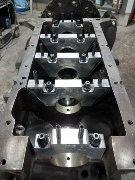

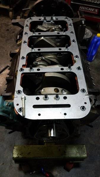

Thanks. Unless I have an unexpected windfall, and get an aluminum, water jacketed 4 bolt block, which based on the pricing I can recall isn't that much more than the 4 bolt aftermarket block options available (please anyone correct me if I'm wrong) then this will definitely be the cap and girdle kit I get. I hope to hit 600 HP, and definitely 650 TQ, with the Torque being a must, HP is flexible. I would like to have the extra insurance for a 100 HP shot of nitrous oxide as an "oh ****" button...

Sounds like we have similar goals, I'm planning on maxing out the stroke (4.5") on a 71 440 block I have sitting around for my Charger.:thumbsup: Hoping for 600 ish numbers.

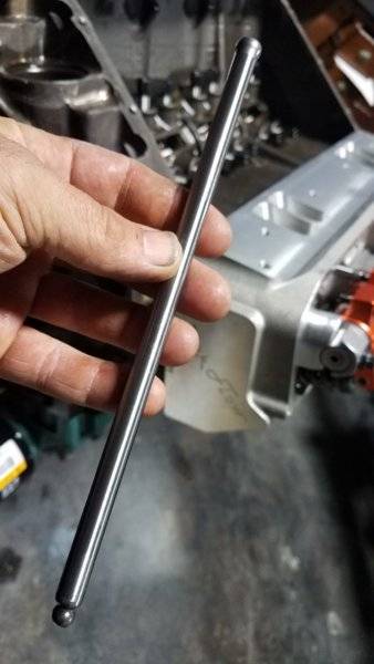

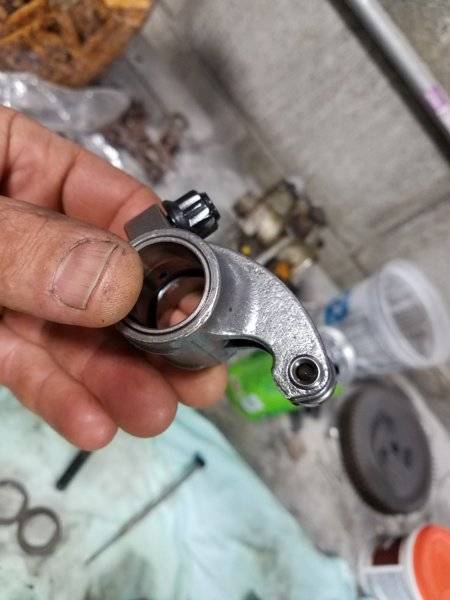

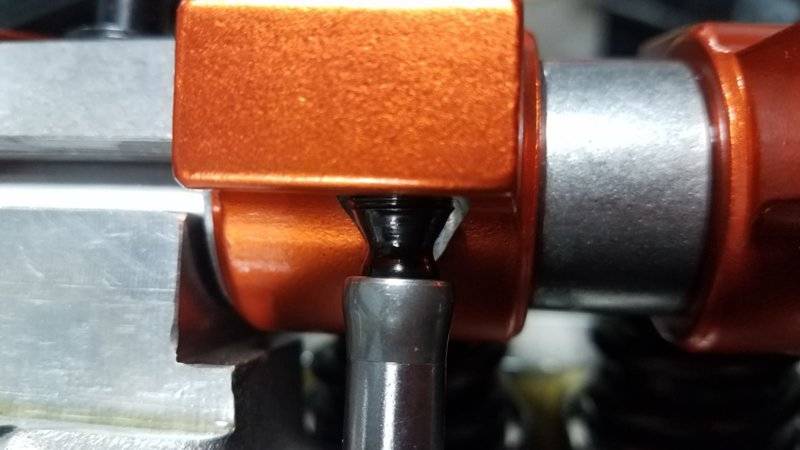

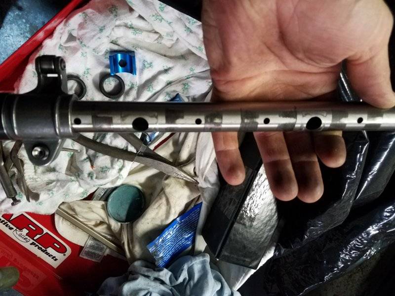

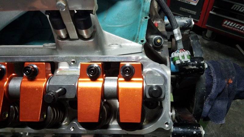

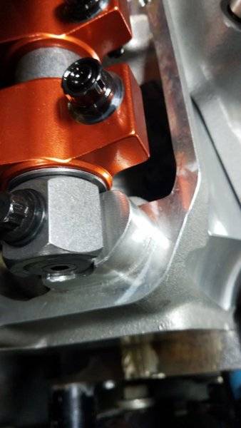

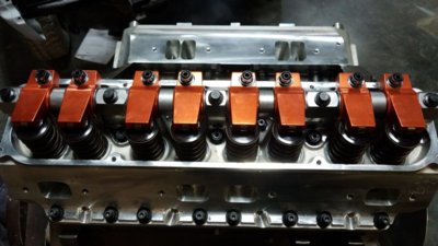

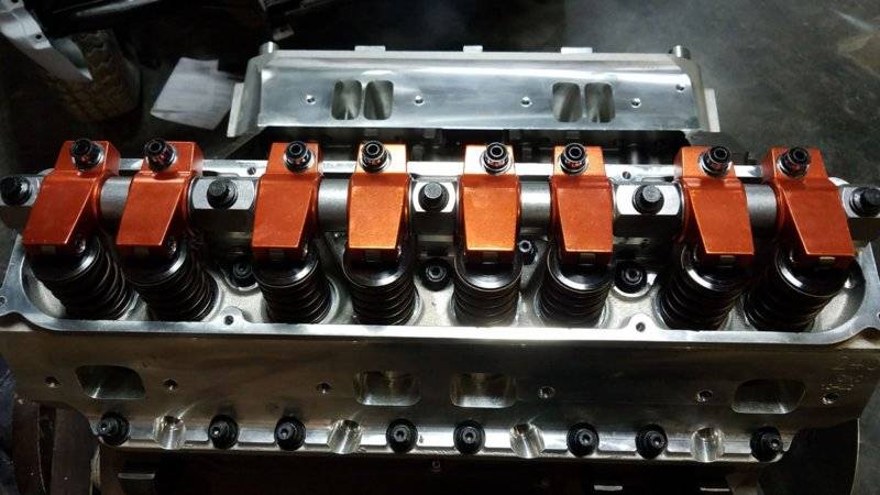

I don't mind building motors for guys like Goon, I give him my opinion and let him make his own decision and he always picks the high road. In this case he started with Stealth heads that had a lot of valve guide wear after 3,000 miles and rockers that looked decent but showed some sketchy wear on the shafts, he chose exactly what I would have recommended. Here's some pictures of why Harland Sharps were chosen. Yes the rockers are stainless and look plenty beefy but the finish leaves a lot to be desired... all that rough finish equals stress risers. The shafts on the other hand had weird wear patterns, after measuring them it was obvious why, they weren't round! Chinese I assume since no brand is anywhere to be found.

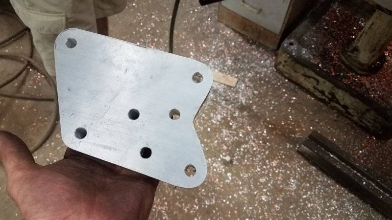

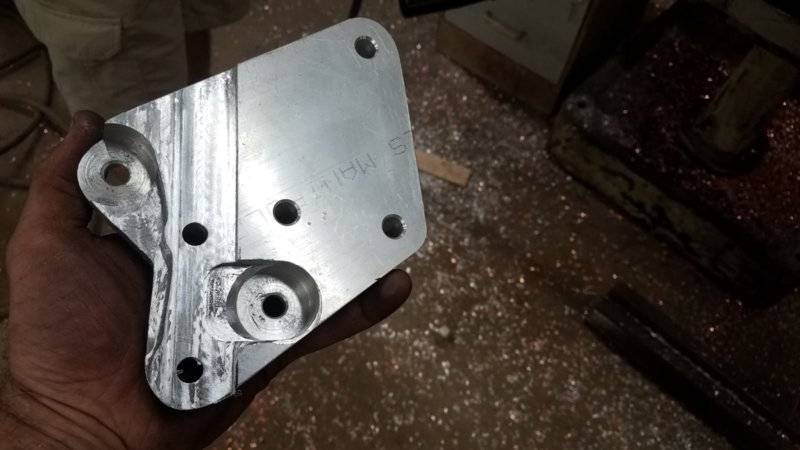

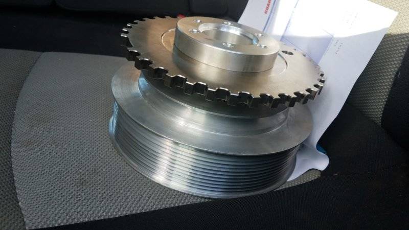

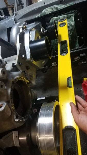

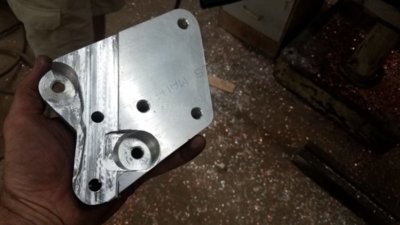

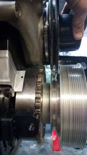

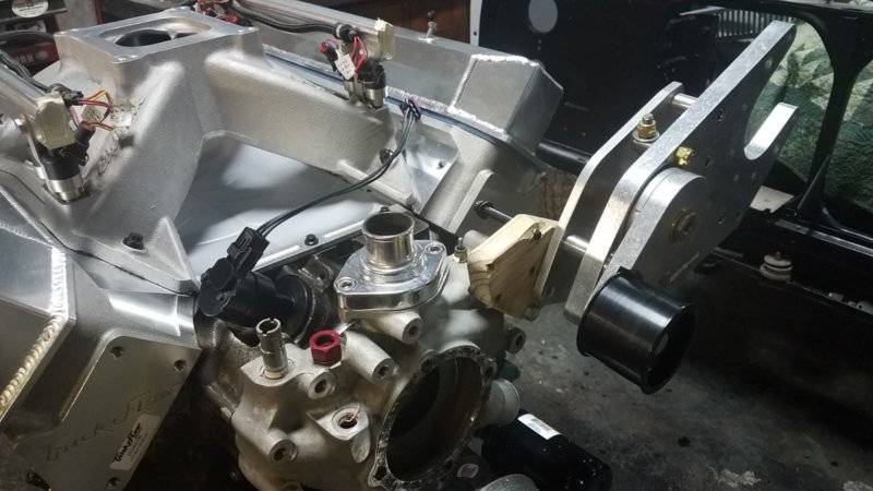

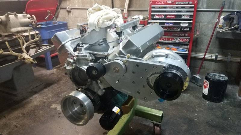

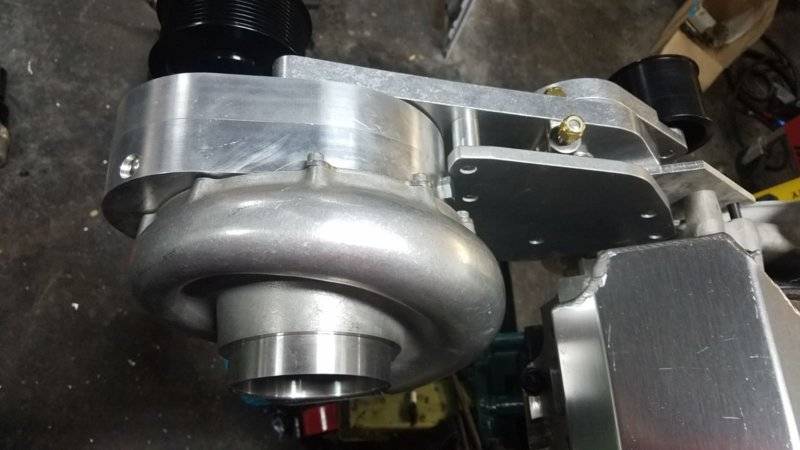

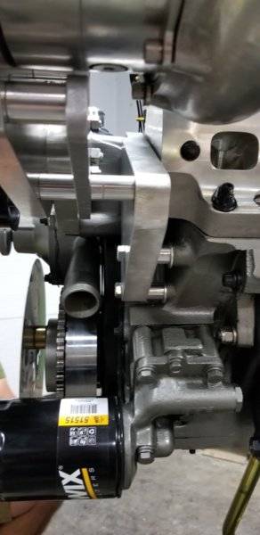

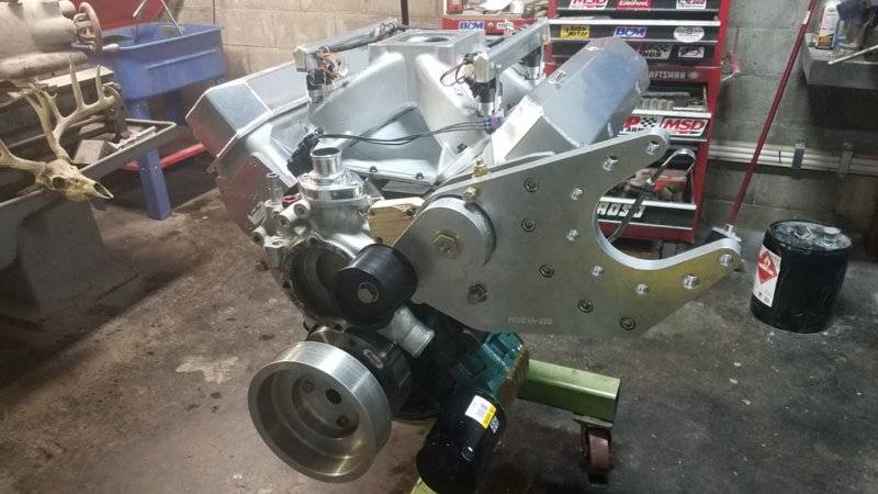

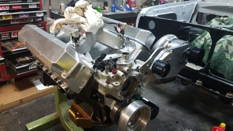

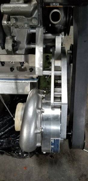

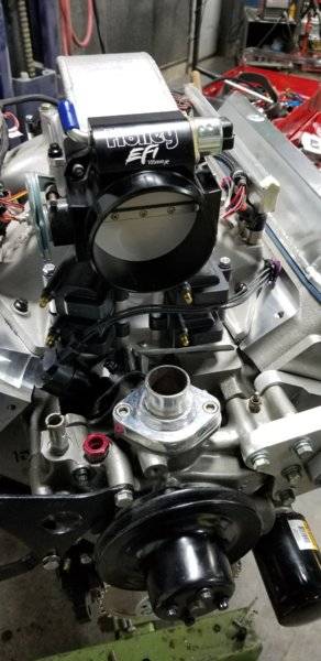

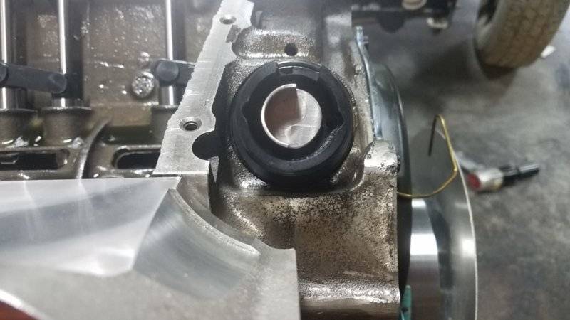

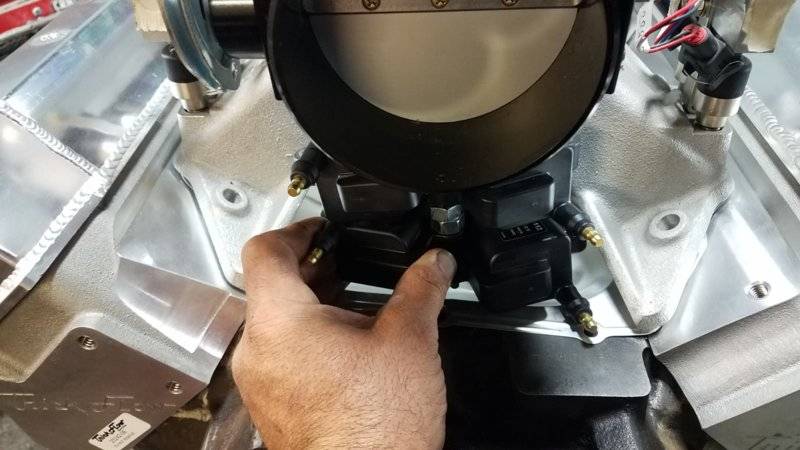

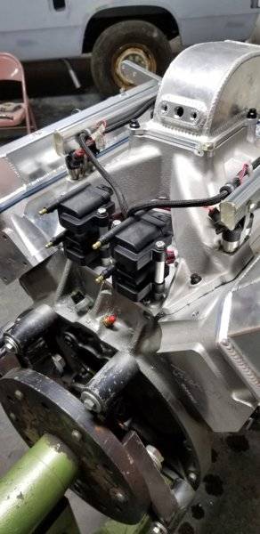

Dev is making it happen and has some great ideas for the bracket adaptor.
Average Joe thanks for the wooden template it's definitely coming in handy for mock up
Using a thick enough stock to start getting the bracket where it's supposed to be and making use of additional holes that the SC Store adaptor does not. Getting closer.
IMG-20190902-WA0003.jpg IMG-20190902-WA0004.jpg IMG-20190902-WA0005.jpg IMG-20190902-WA0006.jpg

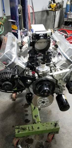

She's all wrapped up for the most part and on it's way home with me.
Bottom line... Dev is the man!
I'll let the pics speak for themselves

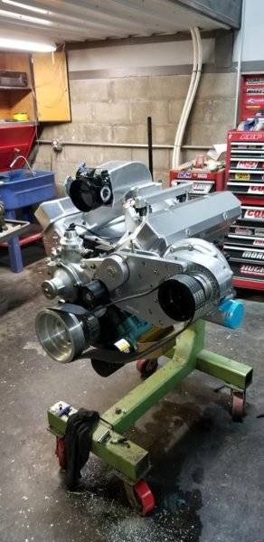

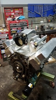

Goon, your engine is a work of art now, and it will be an impressive car to drive when finished. The Toy Chest is an awesome gift and a wonderful gesture from Dev. Congrats to you , and a big WTG to Dev. :thumbsup:

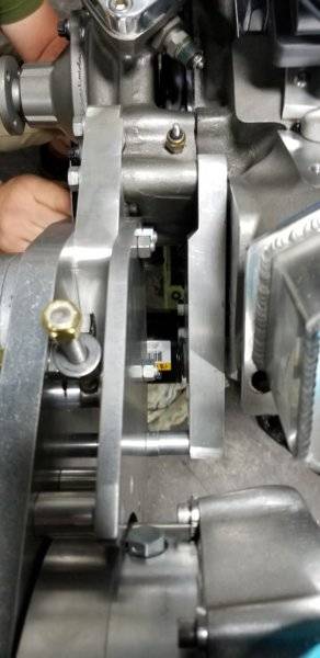

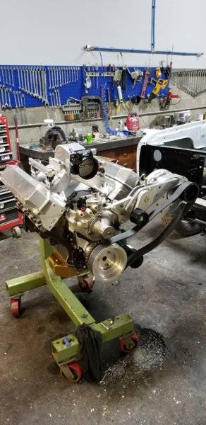

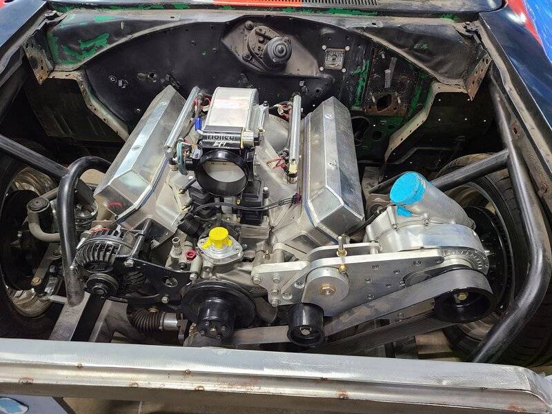

Really Nice Mike ! I like the brace that was machined in to bolt to the cylinder head. Much better than what comes with the kit from The SuperchargerStore.
Nice work Devin!!!!!
Agreed, good call on Devin's part it definitely gives the extra rigidity without having to look at other bracing options
